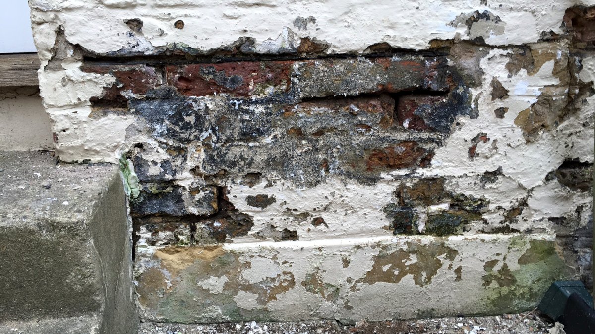

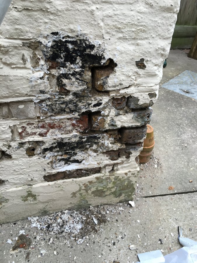

My old 1880s victorian terrace has the usual rear addition kitchen with bathroom above. The London stock bricks have been painted about halfway up the wall by previous owners. They used a non-breathable paint, so the solid walls are cold and damp. Plaster work inside has blown and the kitchen cupboards stink.
Having removed some of the paint, I've uncovered empty mortar joints everywhere and bricks with no faces left which look pretty porous. There are quite a lot of woodlice and even a few worms and millipede-looking things living in the walls, and it seems they have carried soil in between the bricks, replacing whatever mortar was used originally.
I'm planning on having a side return extension next summer, but would still like to fix the wall in the meantime in case I don't end up extending, and to solve the damp issue.
From what I've learnt so far, I need to remove the paint and repoint it in lime mortar. I've had moderate success with PeelAway 7 from the test kit, so would people recommend using that, followed by a wire brush attachment on a drill? Are the porous bricks likely to be a problem, or do they not matter?
Regarding the correct mortar to use, would 6:1:1 or 5:1:1 be better than a 3:1 lime mortar? I've read conflicting opinions and would like to hear a few more! I'm keen to repoint it myself, but does the soil between the bricks pose a more serious problem? Should I rake it out a brick at a time and repoint? I'm assuming I shouldn't do much in one go as the wall might fall down.
Look forward to hearing your ideas.
