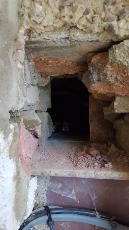

I do have a small side issue, which was the main reason for going for 100mm ducting. As the kitchen is in the middle of the house the duct is to run in the ceiling (floor space to the first part of outside wall, I can't really make the hole any bigger tha 100mm rectangular ducting as there is a part of a floor joist in the way (have attached a photo. Though I have no issue to start and finish the duct in 150mm part of it has to be 100mm rectangular to fit through this gap. Easy huh ;-/

Had 3.5m of 100mm in my old kitchen for 20 years and no problems.Across ceiling void.
but was it working at it's most efficient, the problem is that pressure builds up in the narrower pipe and as endecotp says it then requires a more powerful fan to drive the same volume of air and this resistance can also strain the fan a bit and make it noisy
Thank so chappers. I'm happy to run 150mm but at one point I will have to make it smaller to fit through the opening I have so I guess just use maximum 150mm and minimum 100mm. Not ideal as I'd like to have run one continuous length but will just have to make the best of a bad job I guess

It wasn't until the kitchen surveyor said f needed to be 150mm that I was like b*llocks. But in reality unless I have the duct running across the ceiling it's has to fit in the floor joist space and through the corner of a wall (photo attached). So my only option is 100mm rectangular.
I can start in 150mm reduce to 100mm then go back up to 150mm but that's seems silly. Plus at the end I've got to try and work 150mm back to the 110mm soil pipe....seems like a quandary or not sure if I've missed something really obvious.
I had planned a telescopic extractor so will have a thorough look tonight and see if I can find one nearer to 100mm...
