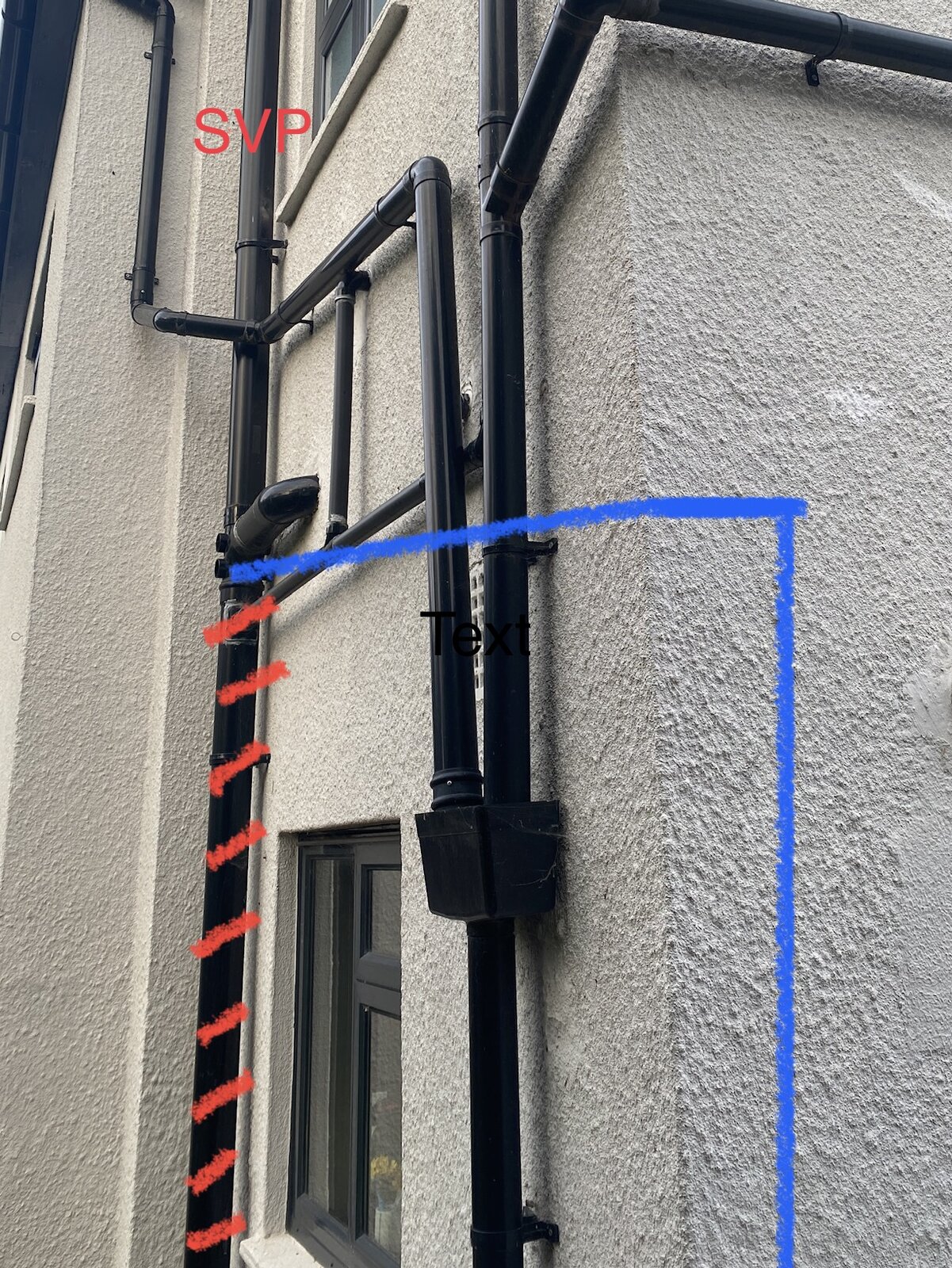

Hi, we currently have a vertical soil vent pipe. It is in the way of where we would like to build a rear extension. I’m hoping someone could offer some guidance here as without moving this pipe we’d be unable to open up the rear of the house.
Is it likely to be acceptable to remove the bottom portion of the SVP (crossed out in red), then route it horizontally across the wall (with the correct fall angle of course), round the corner of the wall to the side of the house and then back down vertically to join a new underground pipe?

Rethink that.
If nothing is draining into that stack pipe above the toilet then what you are really doing is installing a new soil stack round the corner, the loo then becomes a long branch into the stack.
Have a look at Approved Document H
I'm not sure if this changes anything, but there is another bathroom above that one which also drains the toilet/shower/sink into that same stack?
Not regs wise. Better to have another long branch into a vertical stack, you could run into problems with solids hitting an elbow after a significant drop (look at rest bends).

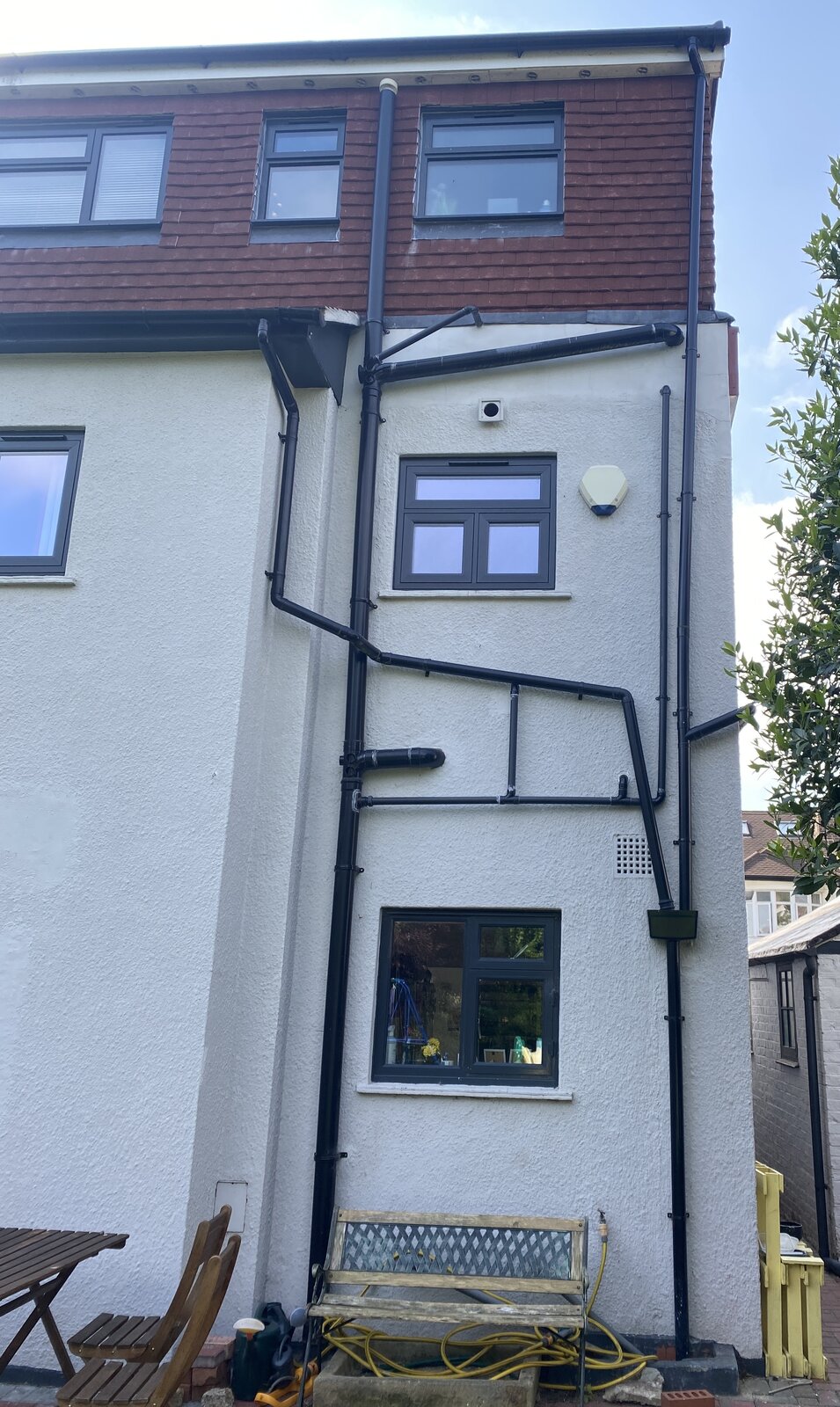

I’ve attached another photo that more fully shows the pipe work up to the loft level.

That pipework looks fairly horrific - thrown in rather than planned.
The stack appears to be non-compliant (venting too near an opening)
Yes you can have the stack pipe inside, though you may encounter problems with noise, any leaks will be very disruptive to find and repair and you'll almost certainly need an indoor manhole for rodding access.
Rainwater pipes- depending on your local policies, you may be required to include a soakaway to handle rainwater from the new extension.
Stack internally is not an issue, box it in, ideally in a corner and you'll hardly notice it. Drain is fine under the building provided it's suitably protected with concrete depending on depth. Ideally needs to connect to the main sewer inside a chamber if it doesn't already so it's accessible if required.
