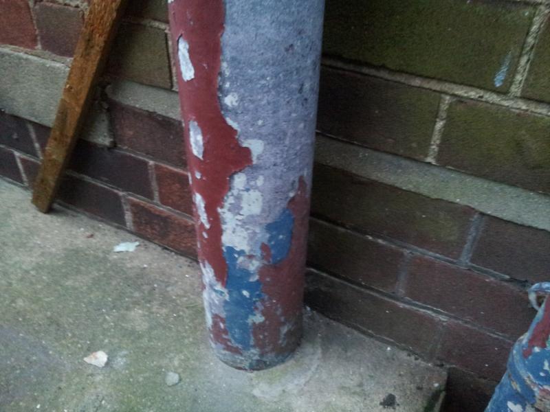

Chaps.....I'm ripping my bathroom out in a few weeks and everything will be going back in a new position.
This involves changing the soil pipe outside to accomodate all the new waste pipes, no problems with that but currently I have a what looks like a asbestos cement soilpipe. I need to cut this about 150mm above the ground, is there an adaptor available to connect the new pipe with the old?
I really dont want to start breaking up the concrete around the pipe and renewing it underground.
Flexseal adaptor should hopefully seal it or a McAlpine DC-1 would be my choice, it'll fit inside the existing pipe removing any danger of an external leak.
Be careful cutting the asbestos, mask is a must as you dont want to be breathing in any dust. Dampen it down as you cut to reduce dust hazard anyway. Not sure how the asbestos will cut, hopefully should be ok, but if it splits down the section you want to keep then it'll have to be renewed.
Yes, damp down well and use a hacksaw or similar to cut. Avoid power tools to keep dust to a min.

Thanks for he reply Hugh, I think you helped me before when my old boiler ran out of oil........new one being fitted Monday :D
Yep mask, goggles, full paper suit, hose in one hand and hacksaw in the other, nice and slowly. I'm not going to start attacking it with a grinder.
I'll google the adaptor.
cheers

DIA surely if the pipe has no strength you would be better cutting it flush at floor level and using a DC1 rather than trying to clamp something to the outside increasing the risk of actually crushing and fracturing the pipe?
Yes Lee or better still going back to the drain pipe underground.
Howevery if you must its much harder the crush it than explode it from the inside.
