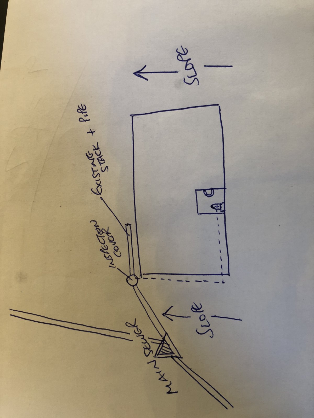

I’m having a nightmare trying to get waste away from a planned en-suite the far side of the house from the existing stack.
Due to a sloping site, three levels within the building and an open plan layout I have two options:
1) Install a pumping station underground to take the soil, macerate and then pump it to the far side of the house.
2) Run a soil pipe 7m along the inside of the house, through the external wall, turn 90 degrees and then continue along the external side wall for 12m before dropping down into the existing stack.
Whilst I’m much more comfortable with the pumping station than an individual macerator in the bathroom is like to avoid it if possible.
Is a long run along the external wall a consideration? I can easily find a fall of 25mm per meter inside and outside with the one right angle in between.
Building Regs state that the maximum permitted length of a soil pipe branch is 6m, so your 19m is well over I'm afraid. Can't you construct a new stack for it and connect into your main drainage underground?
Ah balls!
Unfortunately your suggestion isn’t possible, I don’t have enough fall between where I need the new stack and the existing drain the other side of the house because of the sloping site; essentially the main drain is uphill from the new bathroom.
I’ll post a picture.
And tapping into the main sewer isn’t an option due to time, money and the complexities of the land under which I would need to run not belonging to me.
I think a pump station is going to be your only option then. The soil stack option comes under work which is notifiable to Building Control, who will almost certainly tell you you can't do it.

Is it possible to move the toilet to another wall of the en-suite, thereby saving a metre of pipe length, then use the internal run option. This is becuase I believe the regs do not allow any point to be 6m or more from a rodding point, and not the max length of the run to be 6m. Thus a straight pipe with a rodding point at each end could be up to 12m long.
At the bend where the pipe exits the building envelope, install an access bend (rodding point), then down to the existing sewer.

Interesting. So you’re saying that if I could stick to maximum 6m runs (essentially turning a 12m run into two 6m runs) with rodding points at each end I would meet regs?

Could the en-suite be re planned so the wet goods are closer to the existing soil pipe ?
Only onsite investigation will determine if the only solution is a foul/grey water pump.have been involved in basement conversions where pumps have been required but have always got in a specialist pump installer to install,notify and commission.

You need a Grinder / Macerator system not a Grey water system, personally I would used a duplex system with a high water level alarm even though the costs do add up.
