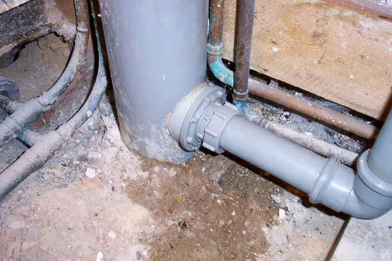

I have a leak from where the boss is solvent welded to the soil pipe.
To be certain of curing it I would like to rip the old boss off including grinding off the old solvent welded collar. And then reassemble with new fittings.
Can anyone identify the boss fitting? (If its any help, the hole in the soil pipe is approx 60mm and there is a threaded component that protrudes out of this. The threaded component is slightly loose, but presently not so loose that I can get it out of the soil pipe.)
I did consider ripping the old assembly off and replacing with a strap on fitting, but given the 60mm hole in the soil pipe, there would be very little contact area to solvent weld - unless someone makes strap on bosses with bigger flanges than the Marley ones at B&Q.
Any help or advice gratefully received.
