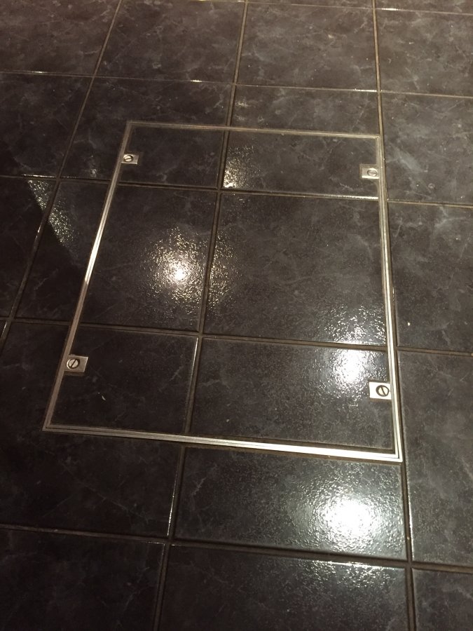

This is in my kitchen extension.
Never had to open it up in the 23 years we've been here, except to fit the double sealed cover when we tiled the floor 15 years ago.
