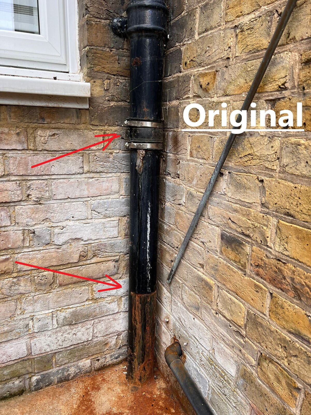

In the original photo you can see there were 2 cracks in the cast iron pipe. When the drain got blocked, the water nearly backed out out the 1st floor toilet, and leaked through these cracks. Previous person put an ill fitting flexible coupler on the pipe.
We called out a local company who charged us £150 to try plunging the toilet (which obviously we'd done ourselves), and gave us a quote for £1500 to bring in some serious machinery to unblock the drains underground.

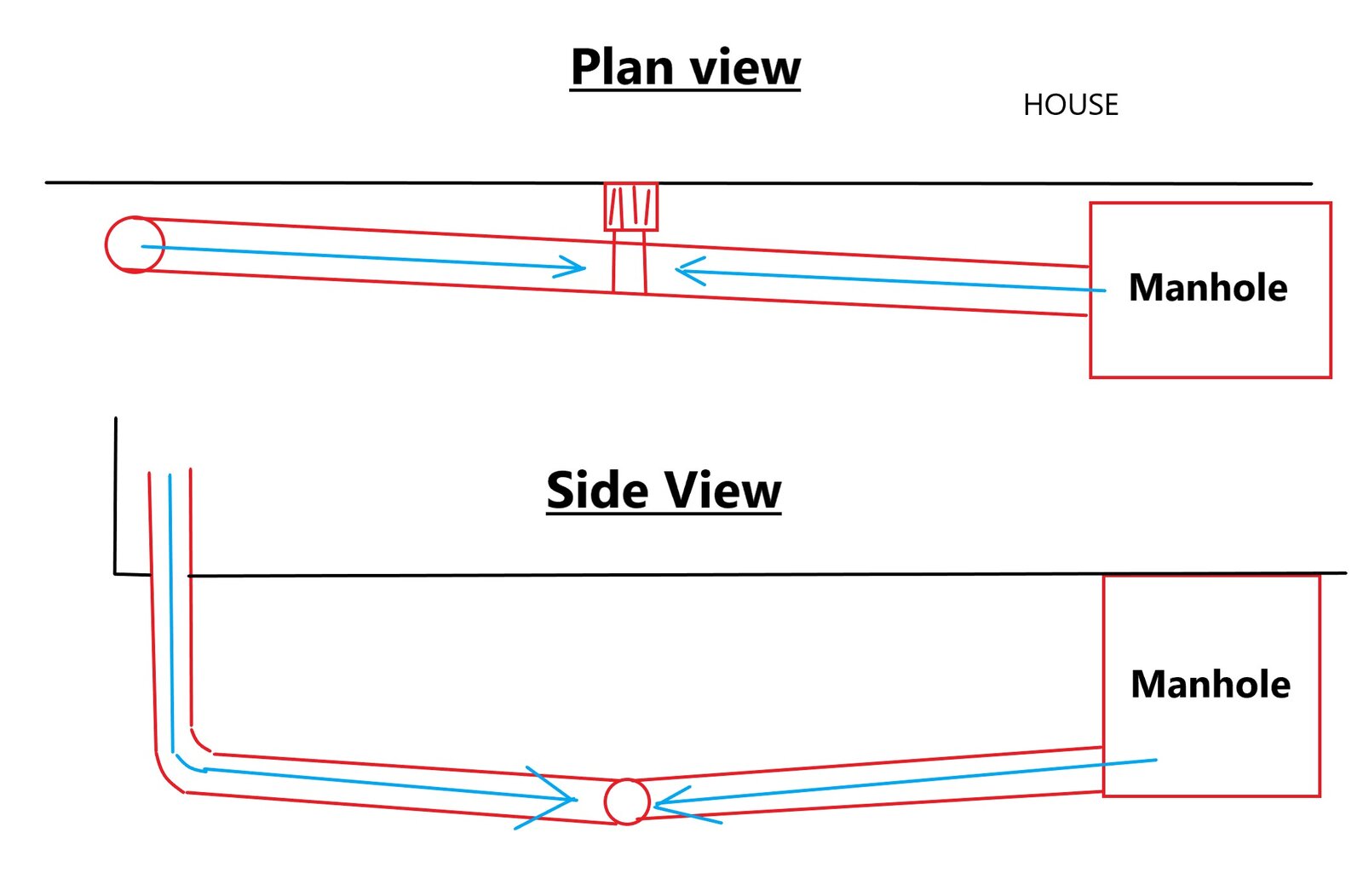

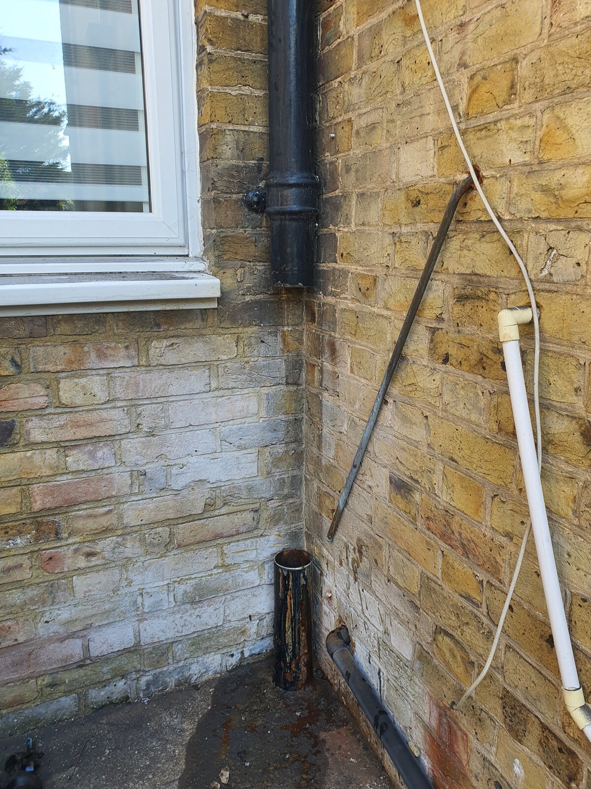

Rather than pay that, we cut out the damaged section of pipe. If you look at my diagram, you'll see you can't rod it around the elbow, nor from the manhole which slopes in the opposite direction.
So with some OneShot, and rodding the small section we could, eventually it seemed to release.

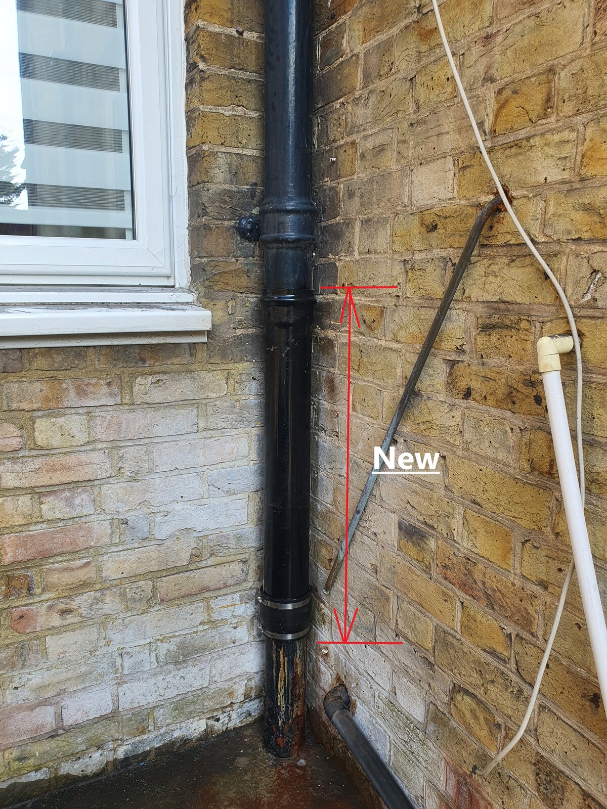

I replaced the pipe with plastic, socket at the top, and a securely fitted flexible coupler below.
Checked the toilet, and it flushed fine
4 weeks later, same problem, and it's also leaking out of that flexible coupler now!

I'd put money on the issue being at the bottom of the stack, either the rest bend at the bottom of the stack, or not far from that, the underground clay pipework has collapsed.
Jetting it with a pressure washer attachment may buy you some time, but really I would advise it needs proper investigation. May be able to get a smaller CCTV camera in from the top, down the stack and have a look what's going on at the bottom/under the concrete, but be prepared that you might have to start digging.....

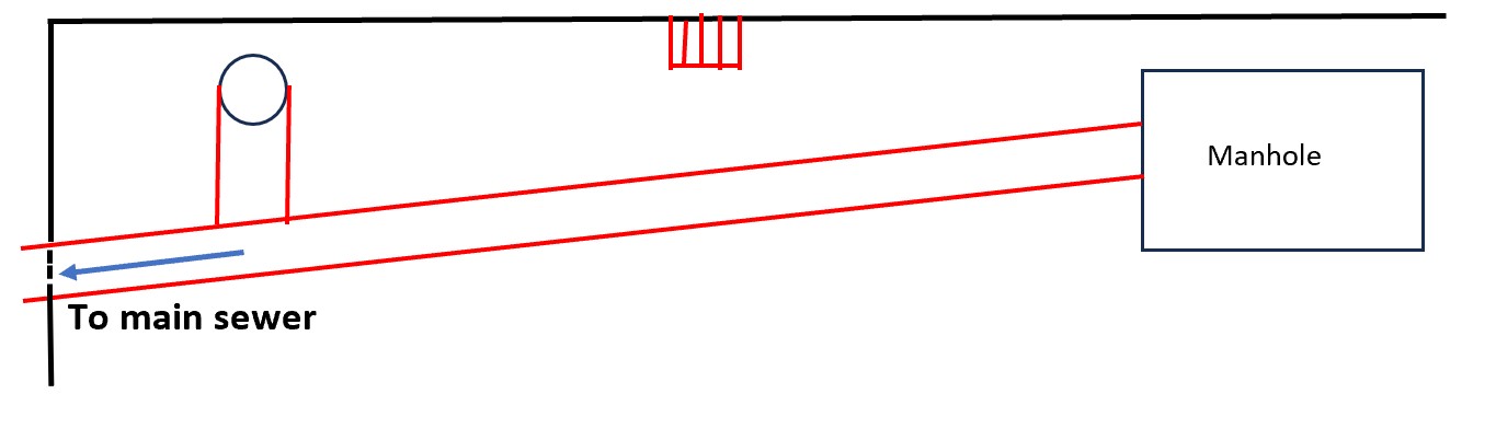

Was referred to a family run company in Canterbury rather than the shysters we employed before. Definitely seemed more on the ball, and went straight in there with a drain camera.
First thing to note I had got the drain layout wrong. They said the manhole ran a straight line, under the building out to the main road, connecting to the main sewer. The vertical soil pipe dog legged at 90 degrees from what I previously said, connecting into that line from the manhole. Which all makes sense.

When they looked at the bend, they could see what looked like a shard of material, that just wouldn't budge. They cleared the blockage, and said we'd probably be ok if we only use 2 ply toilet tissue. Bamboo and recycled toilet paper causes more blockages.
The only permanent solution is complete excavation and replacement of that bend at a cost of £2800.
Interestingly they said that often the cast iron soil pipe, which connects into the old clay pipes in the ground, swells and splits the clay elbow, and this could be the shard of material we saw.
