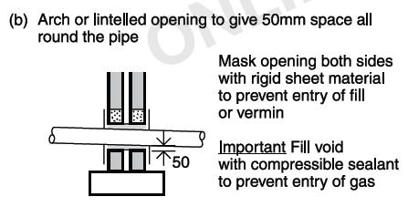

Thanks Marshman for a useful explanation. However, that is not what the regulations require. Diagram 7 in H1 of the drainage regs says that the sheet material is there is keep the fill and vermin out of the duct through the foundations. That is because any differential settlement between the foundations and the pipe will put pressure on the pipe if the duct is full of incompressible material. They want the 50mm gap between the pipe and the duct filled with compressible material to exclude gasses and the fill.

I think your trying to combine two different methods.. here:

Mike, With due respect you are at six’s and sevens here.
Your drawing is taken from Building Regs Part H 2.24b showing drainage through brick footings
Statics drawing is taken from NHBC Good Craftsmanship Guide showing drainage through foundations.
You have two different animals here.
Now you state that your drainage is coming through your foundations which is the concrete as Static shows. Then you have your brick footings which your drawing shows.
If you have a 1050 dig and 750 concrete fill, this leaves you 6 course of brickwork to DPC and 4 course to ground level. Nine times out of ten you can get out through your brick footings if you take a 200 to 300 deep by 450 wide pocket out of foundation concrete when it has addled of.
We work our inverts out before we pour and then we know whether we are coming out through founds or footings.
Coming out through founds is a completely different and awkward ball game.
If you don’t understand what I have wrote, come back and will explain more.
How ever, as noseall stated, 18mm ply is common practice in most situations..
oldun
I know I'm being picky, but I just want to understand clearly what the regs say and how to implement them. You are right that the diagram I posted comes from BR H, section 2.24. However, that says "... at any points where pipes are built into a structure, including ... footing ... or wall" then you need to take those measures, either using a duct as per the diagram I posted or using rocker pipes. The regs do not make a difference between going through a wall or going through the foundation and that at least makes sense.
I am sure that you are absolutely correct in pointing out that 18mm ply is commonly used and I imagine that in the real world that's absolutely OK as you won't likely get vermin tunnelling through the pea shingle and through the foam or whatever "compressible material" you lined the duct with. I do think that putting pea shingle in the duct is a bad move unless you're using the rocker pipe method.
However, if you did get vermin digging through the pea shingle, a bit of 18mm ply is not likely to stop them, so I still do not know what the regs have in mind.
