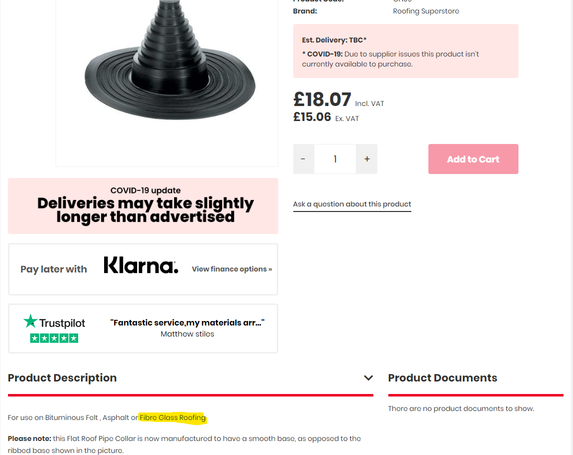

Hello,
Will one https://www.roofingsuperstore.co.uk/product/roofers-40-160mm-pipe-collar-tpe.html of these
Be suitable to create a water tight seal around a 100mm pipe, going through a fibreglass roof? I phoned them up earlier and the chap assured me I wouldn't require anything else.
I also phoned a local roofing firm who said they couldn't do it because they weren't grp specialists and didn't have the correct materials.
Any help would be appreciated.
Thanks, Will.
It specifically mentions fibre glass roof In the product description.

Just noticed it now comes with a flat top rather than ribbed- which won't help the mat/resin bind to it. Think the grp suitable plastic is polyurethane rather than polyethylene....anyhow, cheap and dirty is as catlad-cut your hole, seal the hole edges (resin if you have it, Acrypol or leadmate otherwise), stuff the pipe through, stick the collar down with acrypol (plastic) or leadmate (lead).
