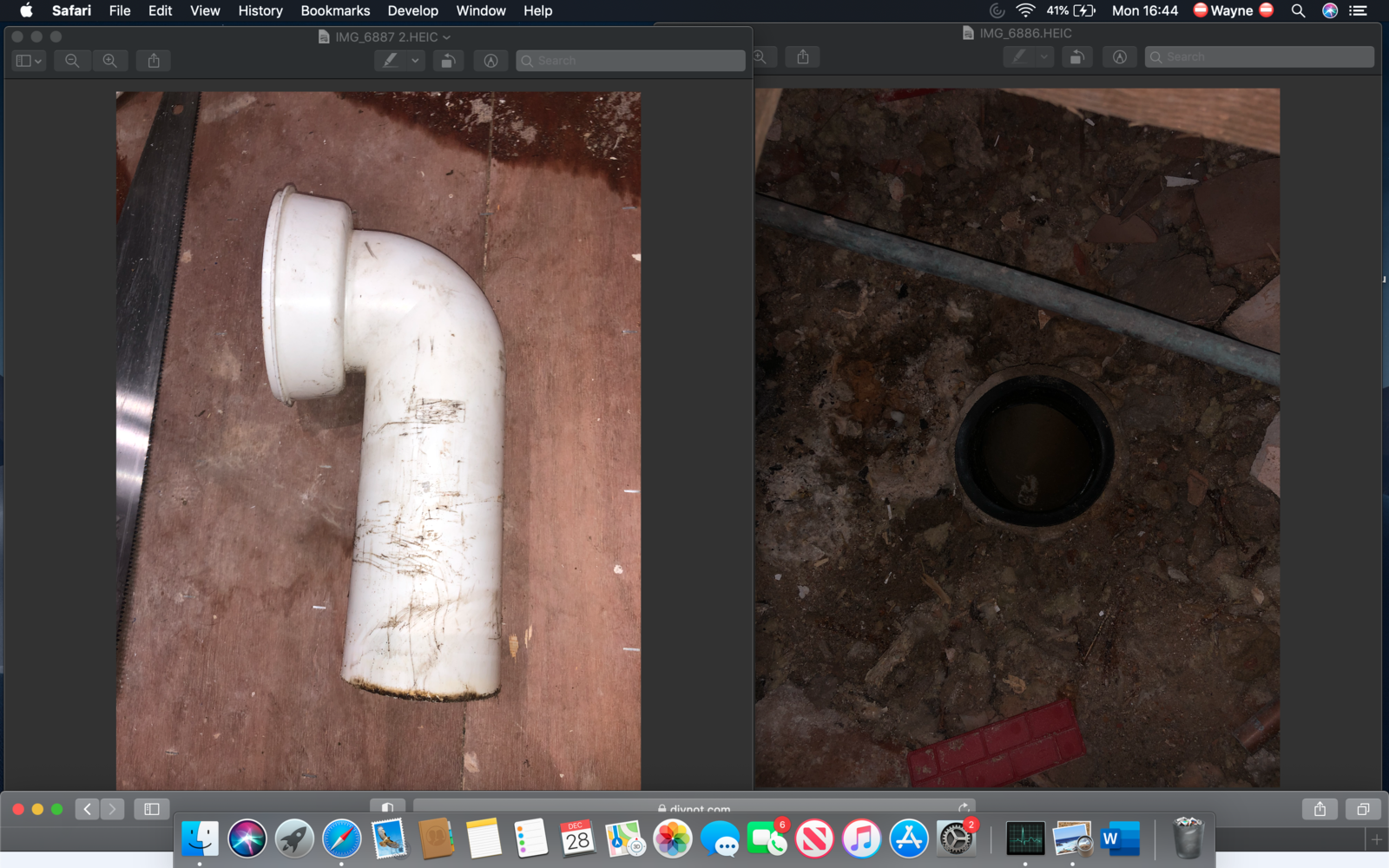

Hi guys, can you help what is the correct fitting to use, I'm after a bend 92.5 or 90 deg to suit 110mm waste pipe one end and cast iron drain the other, the cast iron side is 90mm can't find where to buy it. I have attached photos of what was in place.

Get good quality ones, the McAlpine ones I linked to are hard to beat,
Why would I need the MAC-EXTB wouldn't the MAC-8 just go straight into the cast iron drain?
also when flushing the toilet would a 90 deg bend in the drain be alright wouldn't a 92.5 deg bend be better?
thanks for your help.
No, you said the cast iron measures 90mm (old 3½"). The MAC-EXTB has a 90mm end for this situation, normal pan connectors are 110mm.
ok got you, also when flushing the toilet would a 90 deg bend in the drain be alright wouldn't a 92.5 deg bend be better?
