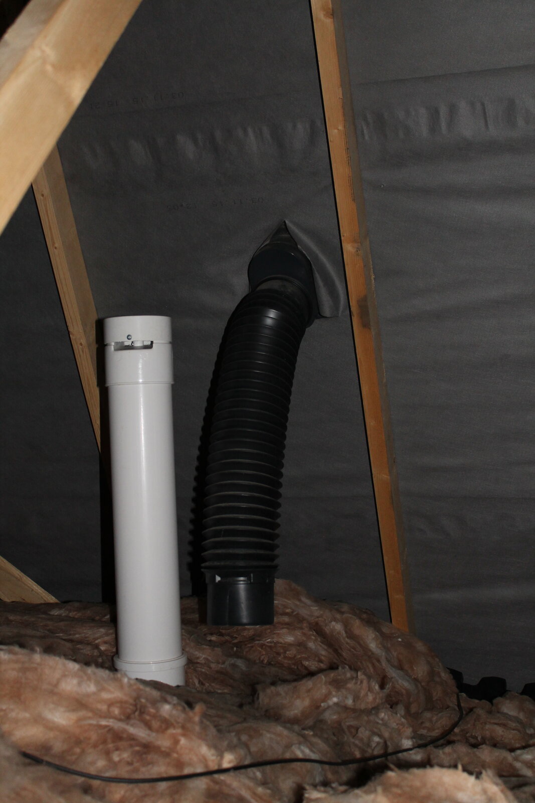

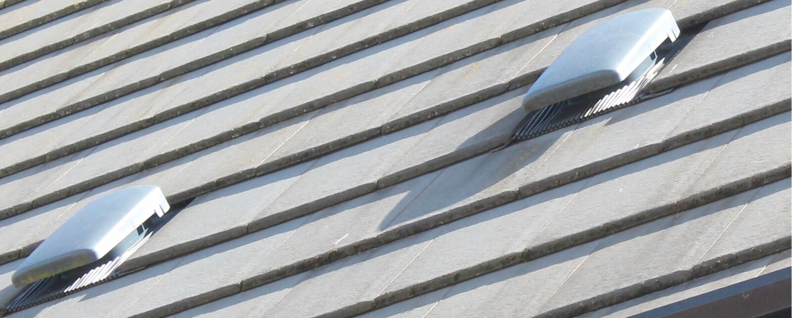

Hi, I have just been up in my loft and noticed that soil pipe which has air admittance valve is next to unconnected roof air vent (please see pictures attached).
Would removing aav shortening pipe and connecting it to roof vent instead give any benefit or is it better to just leave it as it is and cap off roof vent to stop insects getting into loft ?

Is that vent not for the loft though? Membrane doesn’t look breathable type.
House have vented soffits boards fitted.
Thank you, I'll get back up there tomorrow and connect it together, probably just lazy builders who couldn't be ask to do job right. It's a fairly new build (only 4 years old) from Keepmoat so you can't expect to much.
At least they fitted an aav. I found some new builds on a new estate where I work, and found them open to atmosphere in the loft - smell wasn’t good for our tenants during the warmer weather :sick:
Looking at it, I reckon the flexi came up too short to fit into the socket just visible above the insulation, so rather than cut a short piece of pipe to suit and fit a coupling to connect the vent, they just shoved any old offcut in and stuck the AAV on the top.
