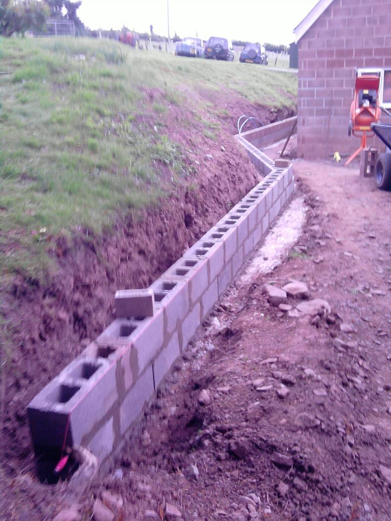

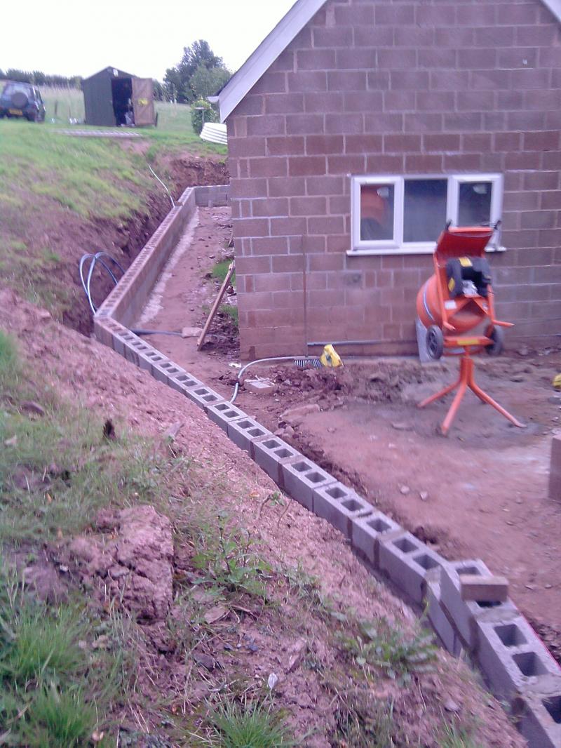

Here are some pics of our retaining wall so far. It is 78 blocks per row and the wall is 105 ft long not 75 as I said before. Still 3 more layers to go then in goes the drainage pipe then 20mm shingle as stated by building regs.
Has that wall been designed or guessed? Looks awfully thin to me. are you gonna fill the voids with concrete? What about reinforcement?
The blocks are 9 inch wide, the foundation has griddwork in it and iron bars to 1 block heigh-then when finished, full length bars are going in followed by concrete. All this is in our building regs plans.
And are there any bars sticking up from the foundation? Is there actually any footing at all?
If not, you may as well not bother with wasting your time putting rebar in the blockwork.
Movement joints in the blockwork?
I look forward to seeing the pix after the winter, when the whole lot's fallen apart.
Ok so you have some sort of footing and some rebar. But the amount the rebar sticks up is inadequate. Should be 450 ie two blocks. How much of it is in the footing? How big is this apparent footing?
It looks like that bank is holding itself up. The crucial bit is the junction of the wall and foundation, so should be OK if the bars are in properly
If it helps, have done quite a few similar (although solid 9" blockwork) walls and they have been up for many years.
Hey, shy ...... is this wall going to contract much if it will be perpetually damp?
Bank surface sloping = greater pressure on wall. Wall stands while soil effectively self-supports; wall ever called on to do what it is supposed to do, wall fails.
Same applies to those you built.
Back of wall might be damp, front exposed to sunlight, so differential expansion/contraction across the block width. Even more reason to form joints.
So how do you join the foundation rebars to the wall rebars after the blocks are up?
