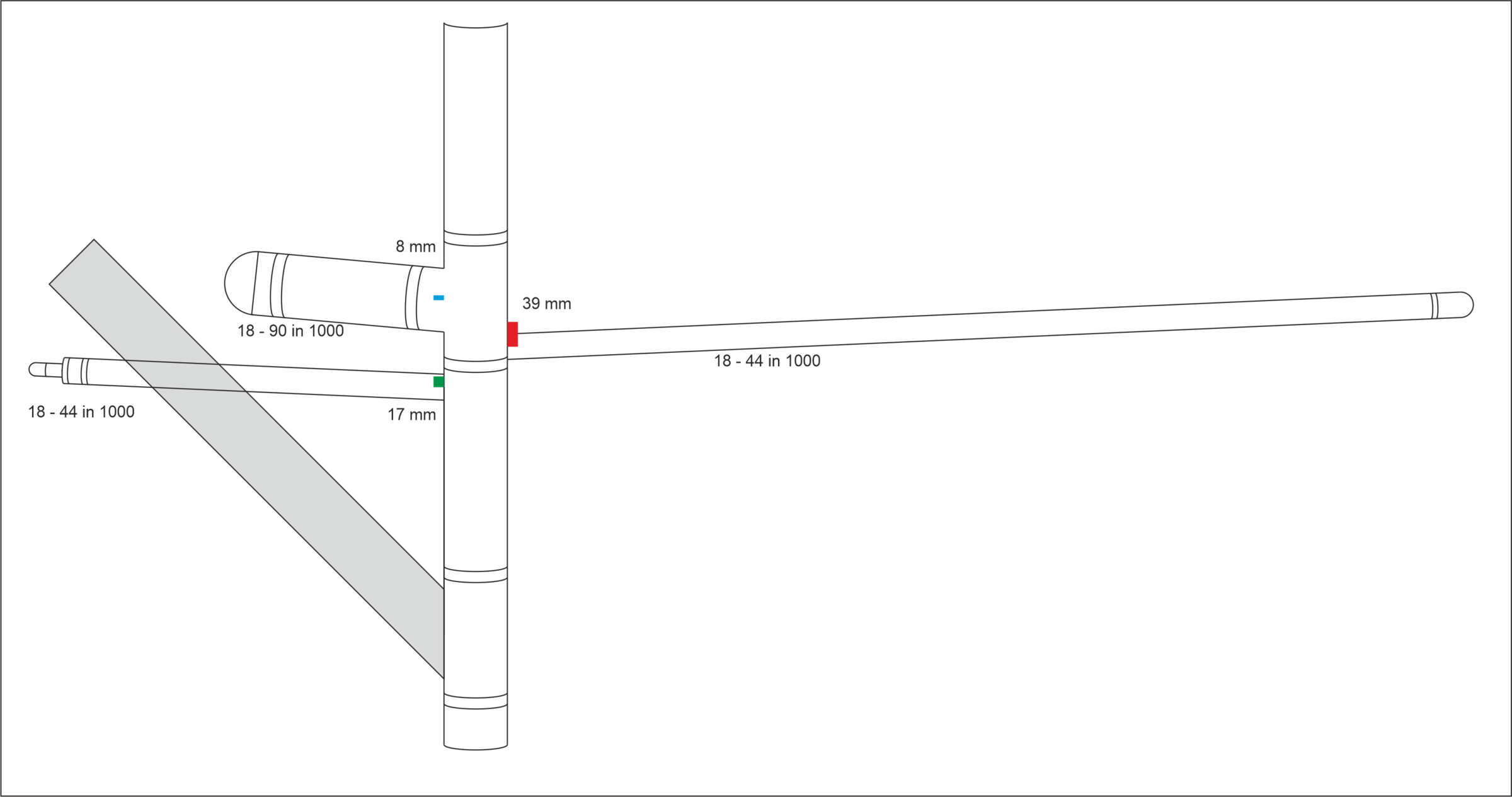

New plan was to replace some of the stack. Add in a T-piece higher up, and pop in some bosses for the 40 mm wastes. This can be seen in the diagram below.
Problem is, there seems to be a lot of issues with potential crossflow. The coloured boxes and stated measurements in mm show the limits of the pipe centres based on building regs limits of 18-90 mm/m for soil and 18-44 mm/m for 40 mm waste. Not a lot of leeway for any of them.
Does anyone have any advice?
