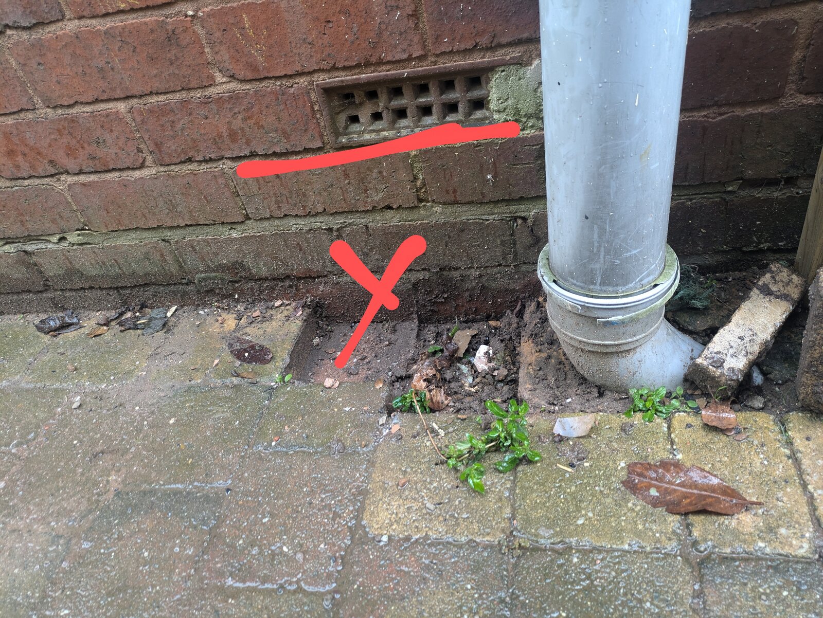

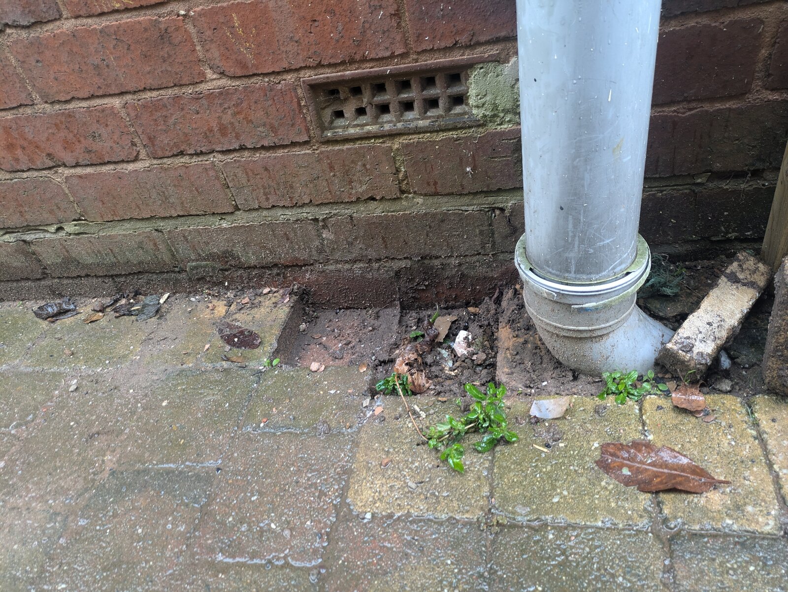

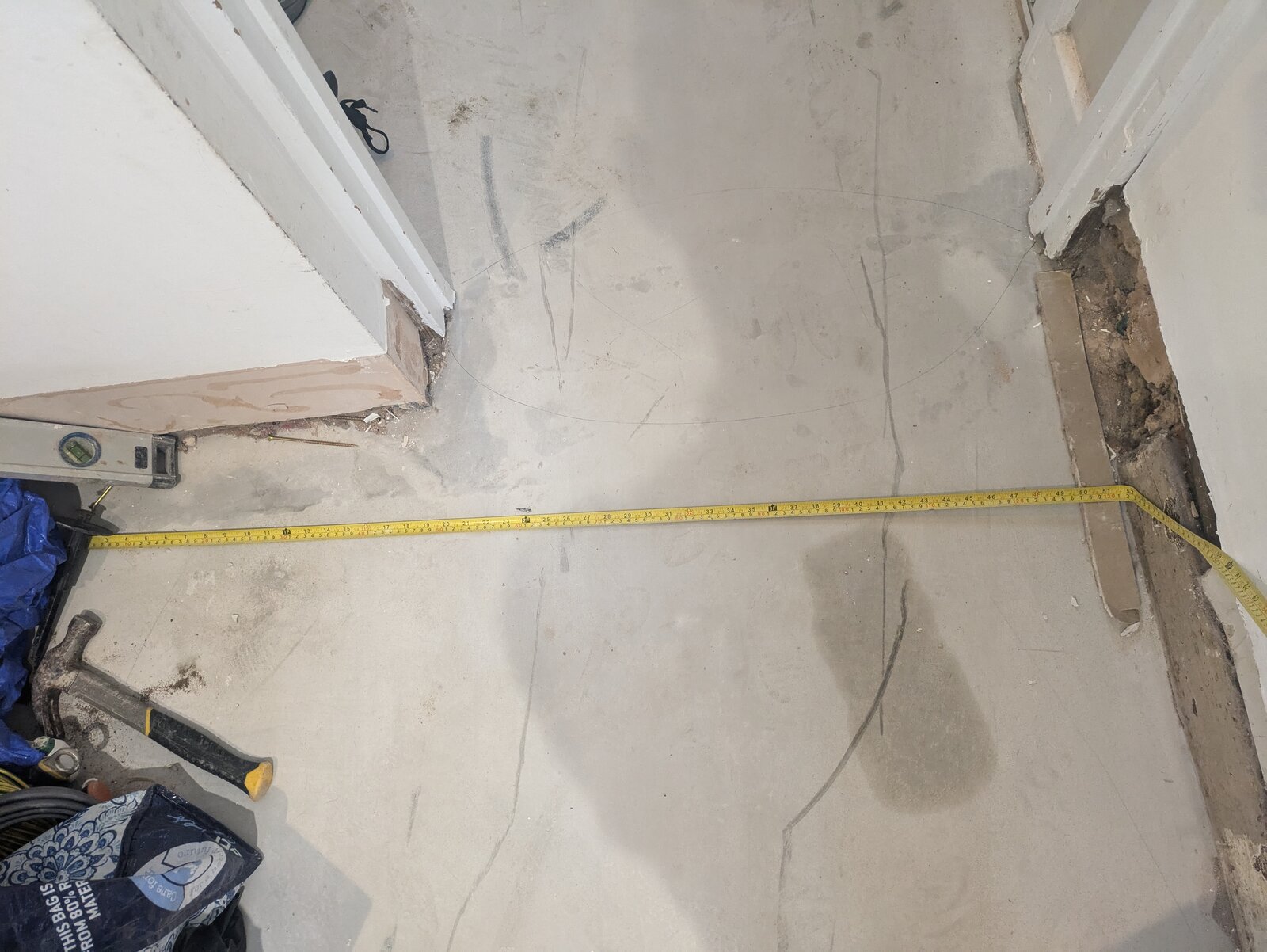

Hi all I was to install a small cloakroom toilet (Toilet and sink in one unit)
From the toilet to the wall is 1.3m
and I have marked where it would come out as planned and where the finished floor is on the external wall.
i know the fall won't need to be a lot in the 1.3m but I'm unsure how to connect it into the soil stack when it gets outside as it will be on the bend that is already there and cemented in
any help would be greatly appreciated

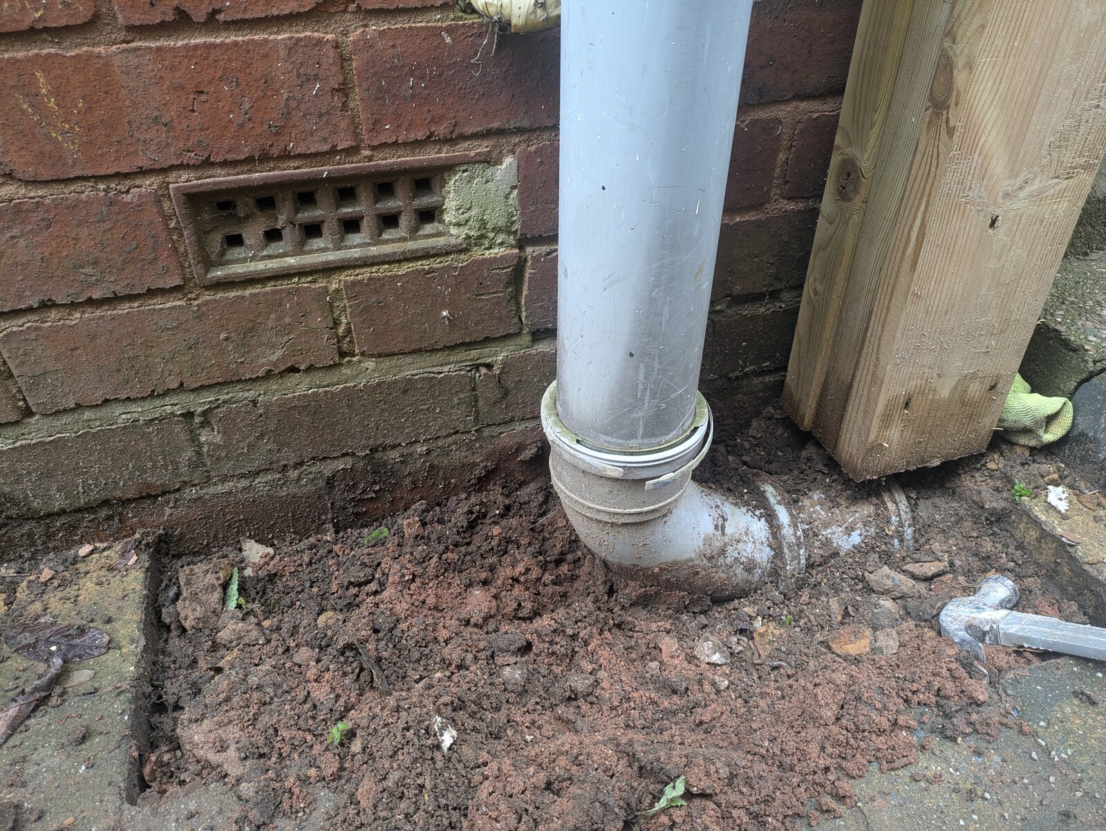

Your never going to get that connected to existing stack as it is.
Afraid that's expose drain and see what's happening beyond that 135° bend which needs replacing anyway.

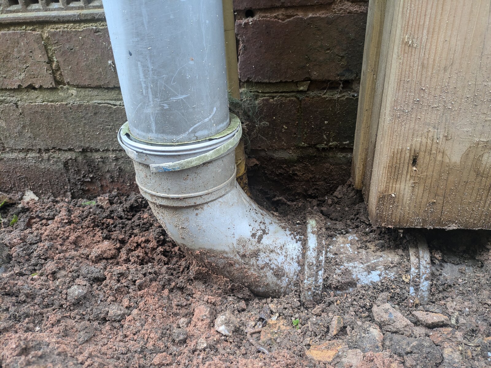

so If I was to dig out the 135° bend and replace it could I then connect into the 135° bend, not sure if they make 135° bends with a connector
perfect thanks mate
I will get it all exposed and take some photos
I could deffo move the toilet to the opposite end of the cloakroom which would move it down by up to a metre away from the original stack.
a bit more exposed

How tall is that vertical stack? There's very little you can do at that point really as it does need that rest bend where the pipe turns horizontal.
The other problem you may have with that would be there is a min of 450mm required from the lowest connection to the stack and the bottom of the rest bend and you wouldn't have that the way it is at the moment.

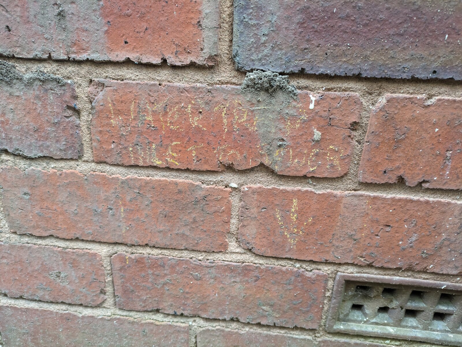

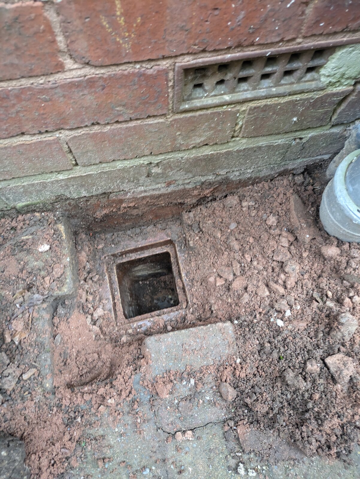

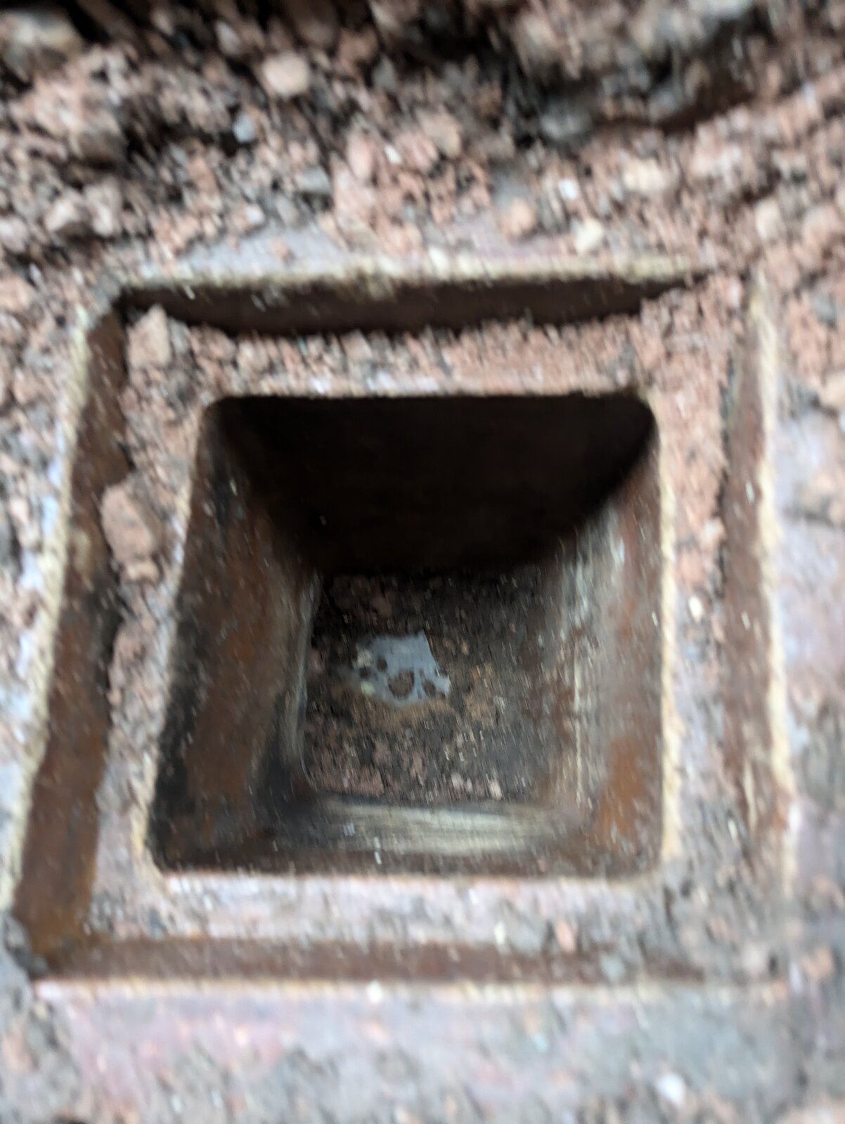

found some markings on the wall from old owner and it says water trap inlet for sewer. No idea what this is if it's useful or will cause a problem.
If there is another wc into the stack on a floor above, you have a Single Stack and the 450 is to stop a higher discharge interfering with the lower wc connection . If no connections I would argue against it with B.C ;)

I'm a complete novice here, am I right in assuming you and MadRab are saying there needs to be a minimum of 450mm between the bottom of the bend and the bottom of the new pipe connecting into the stack?
if that's so I don't think it's going to work with a standard toilet, would I be able to fit a saniflo - would the pump be able to push up the increased gradient
Completely agree and if it was just a dry vent then there would probably be no need for a rest bend and the 450mm would have been moot but given it's configuration the presumption was it was wet, servicing a bathroom on a first floor, hence the question. ;)

Looks like an old clay trapped gulley minus it's grate.

That pipework is very shallow, where does it run to from there, any idea?
hi mate it runs to the chamber we have in the alleyway about 3 meters away it does drop quite bit once it hits the chamber
Just do a bit more digging, that plastic is probably higher than the original pipe and in any case you can connect lower downstream if necessary.
