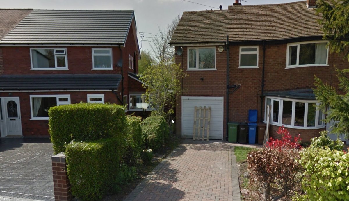

I am going to be taking on a Self Build Single Storey extension in the next few months where i plan to remove a bay window and bring the downstairs out by 1500.
I have been pondering over the soil stack and trying to figure out the best way of getting this watertight in my new lean too roof, i am not a big fan of the flexible roof vent covers and im not sure ill get one in with the pipe so close to the house wall.
Can anyone help me on this?

This is the front of my house:
and as you can see from my amazing art skills, the soil stack will be in the roof space of the extended garage.

Can you fit a dergo valve on the inside of the bathroom about 300mm above the highest outlet (basin?)?
Someone skilled with lead should be able to do something, possibly make a slate and incorporate it into the flashing. I'd be cautious about doing away with the vent, it is there for a reason. People remove vents, and fit an AAV then wonder why problems occur....
AAV's must be fitted where they can be accessible for maintenance ie. lifting up and out. Headroom is required above the AAV.
They should also be fitted above the flood rims of any fixtures that they serve.
Strictly speaking, its doubtful that there is enough height available in the proposed lean-to roof - but on site many Regs are skimmed.
I dont see a manhole in the pics? And the S&V pipe appears to have been moved to its present front elevation location when the 2-story extension was made.
The neighbour's house is set back - check if planning will allow your more forward front elevation, it will project beyond the neighbours extn.

Check on the planning and Regs forum for up to date accuracy ref set-backs. But be certain: no guesswork.
If you go for a lead slate then pulling the S&V vent pipe away from the wall will give you more room (at least a full tile) - dont end up squashing lead into a narrow gap behind the vent in its present position.
You or your plumber would work easier if the vent is lifted from the Tee - it will help locating the lead slate position and cutting a chase for roof cover flashing.
