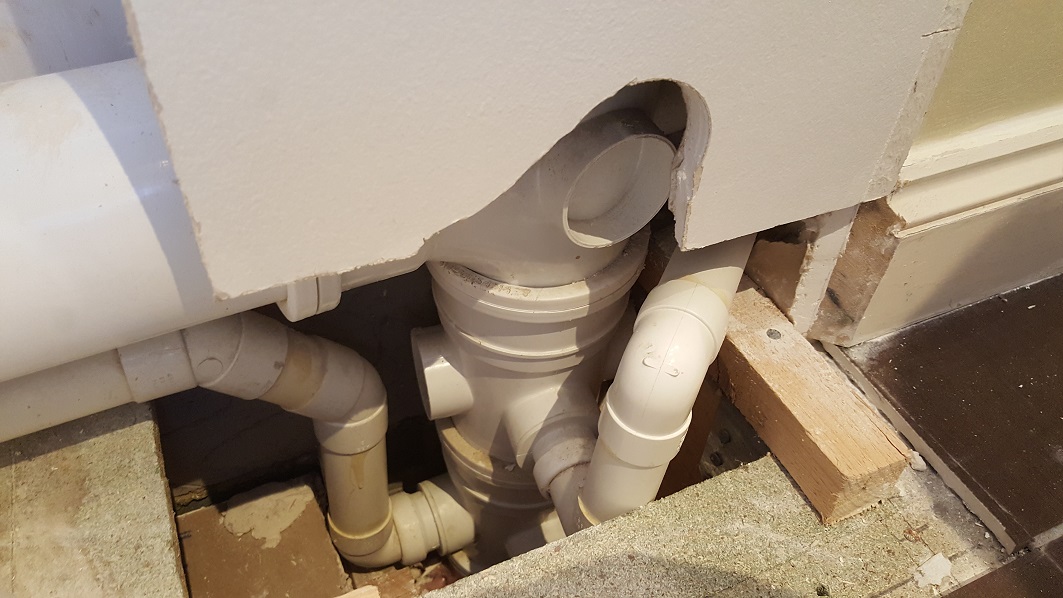

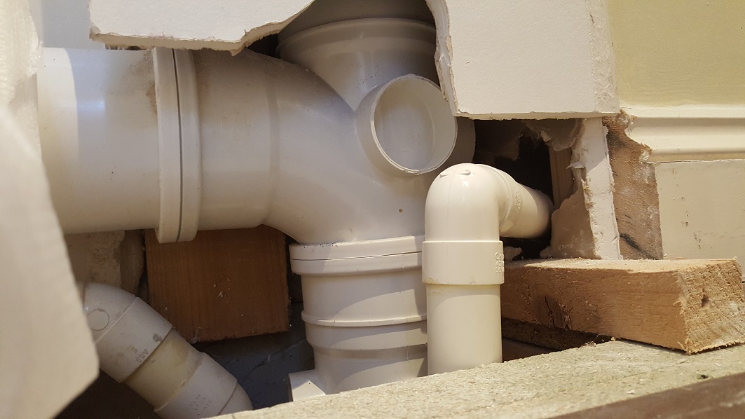

I am refurbing my ensuite, upon removing the boxing I've found a triple stacked tree arrangement with a single waste entering each level... WC on top, sink waste in the middle and shower waste at the bottom.
The issue being is that the previous DIY'er routed the sink waste around to the front of the middle tree which now prevents me from moving the boxing all the way back to where I want it. So I have two questions about this:
1) Can I plumb the sink waste into the opposite side to the WC waste (why three separate trees?), I could cover the pipe with some purpose made boxing.
2) If the above is not possible or I want to completely hide it, can I use the same sink waste tree but plumb it into the opposite side to the WC waste.
See attached pics for an idea of what I am dealing with
