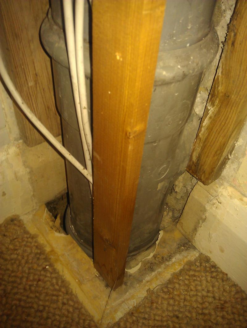

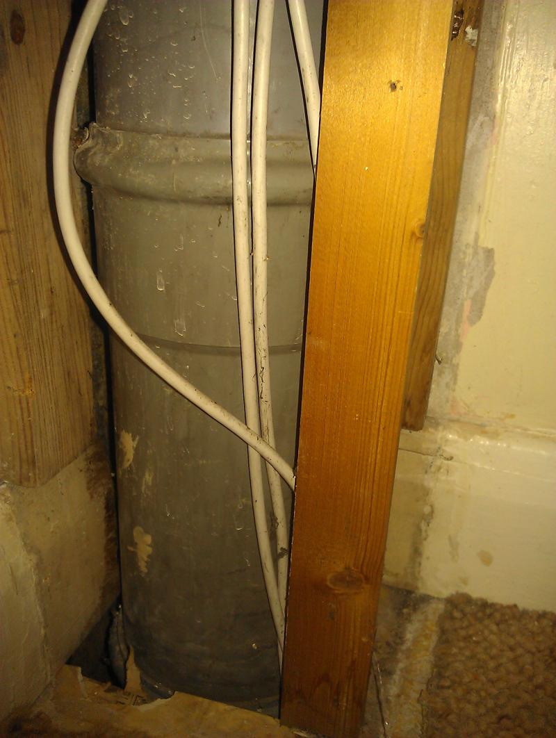

Is there any way of telling whether a joint on a 110mm soil pipe is push fit or solvent weld just by looking at it ?
The plastic pipework is in a late 60's house with the T to the WC labelled as 'OSMA 4" / 110mm'.
I have attached a couple of pictures below:
Toilet connection to 110mm OSMA soil pipe.
110mm pipe goes through side wall of toilet (single skin block) - plastered flush to pipe !
Into soil stack in adjacent bathroom (1st floor).
Upper joint in stack between pipe and 90 degree T in from WC side
Lower joint just visible at floorboard level (joist below board appears to butt up tight to stack pipe).
I am actually looking to remove the WC and relocate it into the adjacent bathroom to the left of the soil pipe. Looking at it it seems that:
Some plaster / wall will have to be removed to extracate the existing t jucnction (There are not roof timbers resting on the wall between the wc and bathroom - subject to getting a professional opinion I am hoping to remove this wall as part of refitting the bathroom - Shower cubicle to be installed in old WC space).
Having looked at the roof the soil pipe exits the roof and has some lead flashing making this juction weatherproof. Is there a risk that this junction gets compromised if trying to separate the push filttings (if indeed they are).
Cant budge any joints at the moment although this is primarily due to being fixed through walls etc. I am thinking of removing the WC so that I can try its 110mm pipe fitting (photo 1) to see if that separates.

all your pics show ring seal joints, the bulge you can see on the fittings contains a rubber sealing ring inside, if the soil pipe has been in that long you are going to have trouble removing the pipe from the fittings & even if you can i doubt the seals will be able to be reused, the lead slate on the roof should have a weather collar on it that fits over the pipe then in turn over the top of the lead slate, you should be able to push the pipe up but there is no guarentee the weather collar won't get moved so you may need to get on the roof to make sure it is sealed, not something you should do without the correct ladders/tower/scaffolding & safety equipment

You can buy soil pipe and fittings that are push fit or solvent weld.
The pics show push fit.
The get the fittings apart you normally have to twist them and hope for the best.
The pipe where it goes through the slate, should have a skirt which is the weathering collar, so the pipe should lift up with any luck, if not get a slip socket and cut the pipe.
