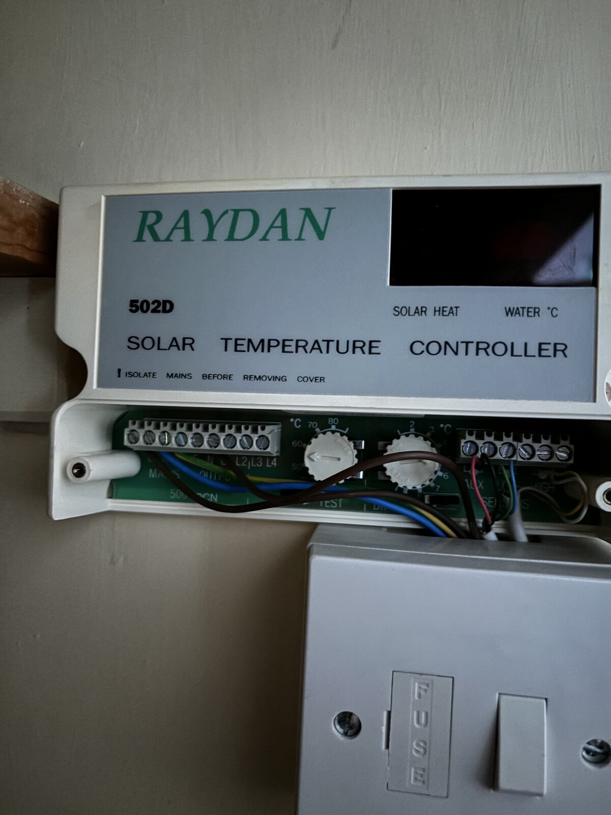

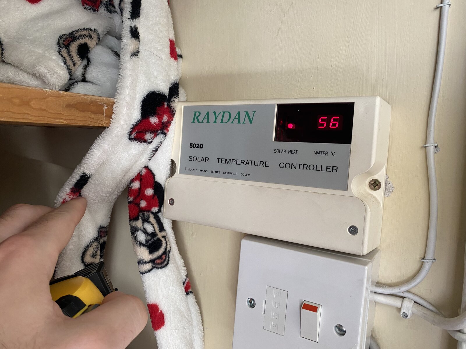

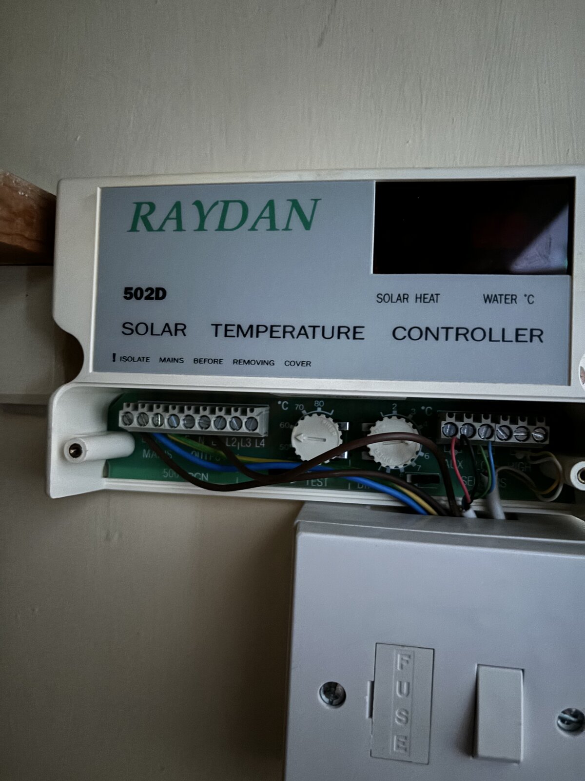

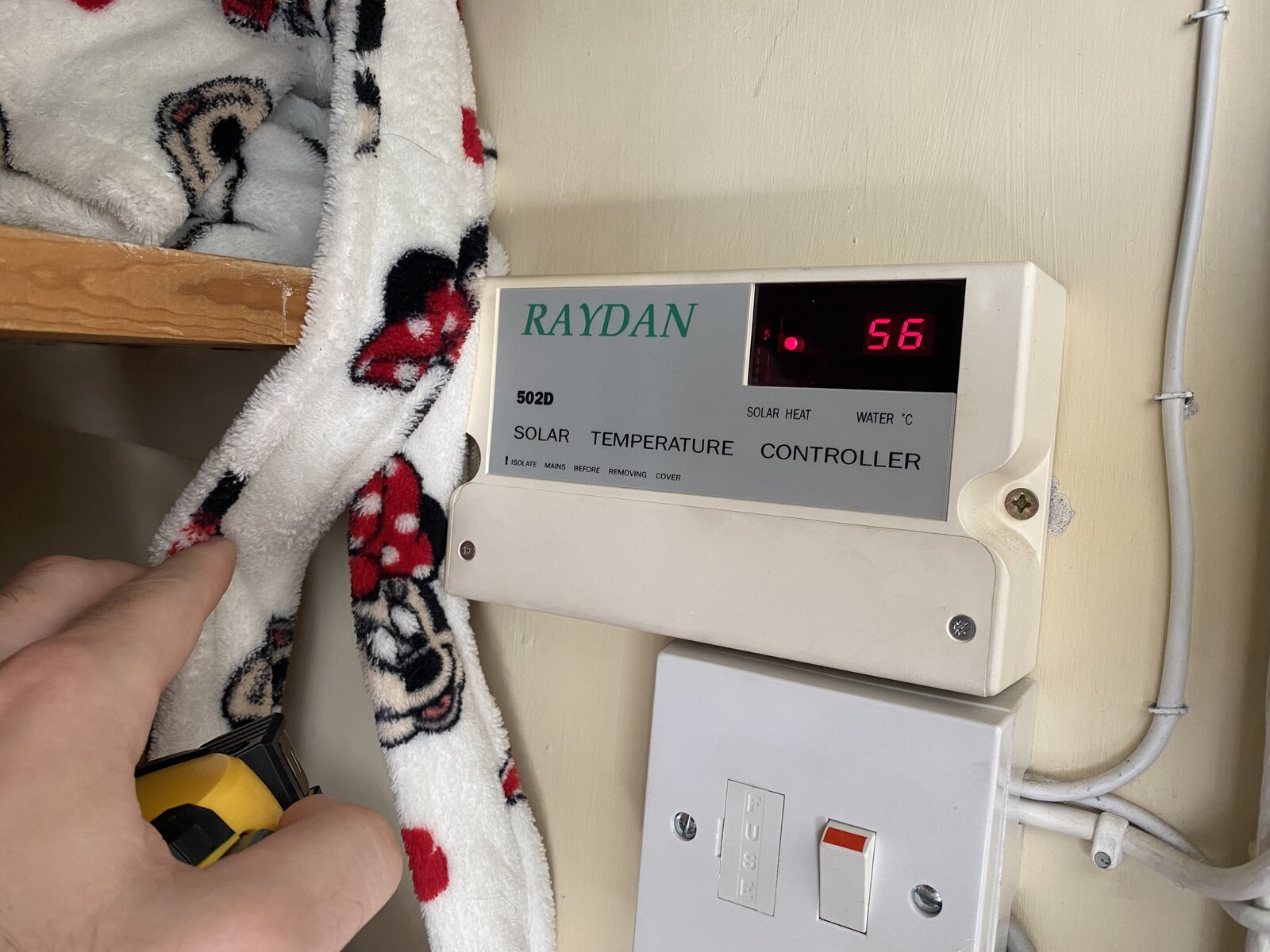

Hi,
Got solar hot water tubes on the roof, don’t know much about them but they don’t seem to operate correctly, when there turned on the raydan controller temp display is very sporadic and jumps around and occasionally the relay which controls the circulation pump is constantly clicking on and off,
regardless of that happenning the pump gets red hot.
I’ve checked the temp sensors and they seem to be giving me a correct reading when measured.
Anyone got an ideas?

Okay so there’s a test button which doesn’t seem to do anything and a DIF test, when I slide this the pump kicks in and sounds like water is flowing, when I test both at same time the pump is on but the temp display disappears,
There’s settings to adjust the degrees and the differential(1-10) when I lower the degrees it sorta sounds like the relay is failing? But surely if the relay is failing then the pump wouldn’t come on at all?
Unfortunately I have no info on it, the previous owner left nothing, and I can’t find any info on the internet

Sort of resolved it- NTC probes are fine, opened up the controller, changed all the caps and the transistors and checked relays, two boards were connected via screws which I’ve swapped out for link wires as I suspect a poor connection.
The temp is still a little sporadic but no where near as bad and the relay no longer constantly clicks on and off, the pump still gets very hot when on for more than 2-3 hours so I’ve turned the pump speed down to counter that
Thanks for your replies
