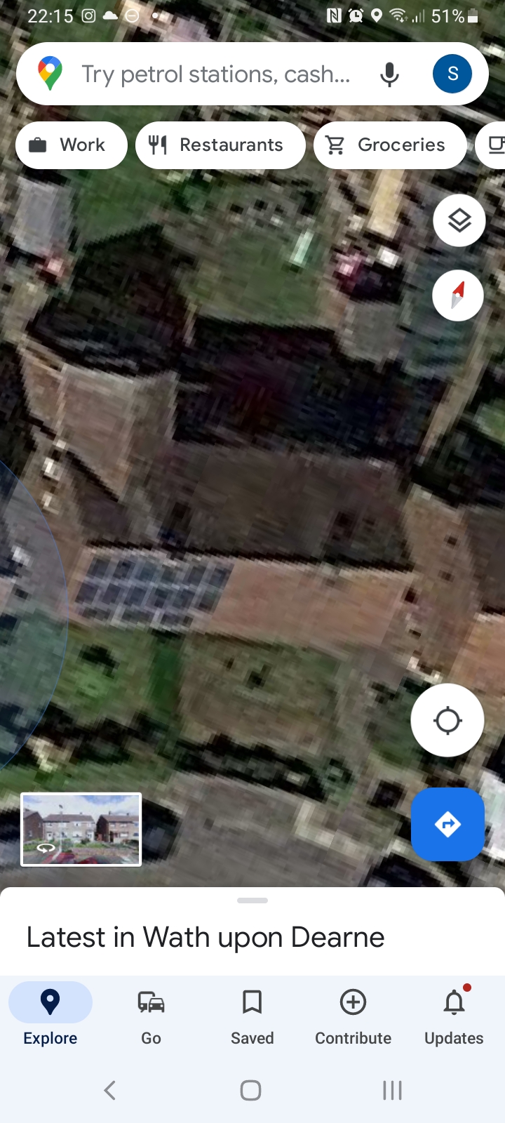

Our house needs a new roof. Currently rosemary tiles. But would like large format grey tiles (name?) two other houses in our street have done this.
Would like to integrate solar panels into the south facing side of the roof. Next door has the entire roof covered but theirs are on rails, in the usual rent a roof manner.
I'd prefer mine integrated into the roof as I want the house to look sleek and modern. There will be more solar than tiles though, I want as much solar as I can fit on the roof.
