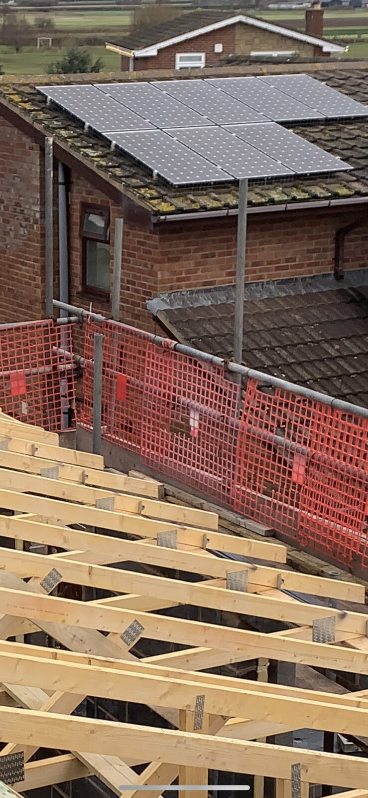

Hi All
I am currently selling my house however, I have am issue with pigeons going underneath my solar panels. I'm looking for a fairly cheap and easy fix. I've looked at a few different systems with varying costs. I was thinking of using pvc gutter guard with some kind of clip system. Has anyone else used a similar DIY approach that you could recommend? thanks for your assistance

Hi,
My neighbours had the same problem with pigeons nesting and got some wire mesh fencing and fixings and came up with a tidy solution.
This is me taking a picture of my extension trusses, but you can see their panels with this solution. Quite discreet.
Cheers
Andy

thanks for your reply, ive found similar systems. Its the fixing detail most of interest, one I've found the fixings stick on to the side of the panels. I'm not keen on this from a longevity perspective. An alternative is plastic clip system, although I don't know if my panels have a lip to accept the clips

Presumably the panels have verticals that hold them off the roof? So a tube of chicken wire squeezed in would self support for a while, but a wire bent around the vertical and then into some of the mesh would hold it together? Rust might be an issue so stainless might be better. I suspect that nylon cable ties, although great for speedy fitting, would suffer with UV light.

yeah there's a rail system which the panels fit on. Ive seen screwfix do some welded mesh in lengths which if cut to the right depth would maybe look neater than chicken wire rolled up. If I could come up with a suitable fixing method I think that would be a fairly inexpensive solution
