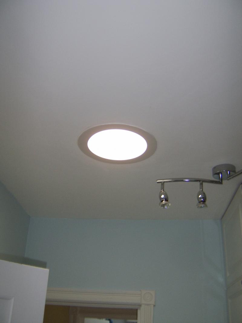

Has anyone any experiences of using solar pipes / light pipes / whatever to get some natural light into a stairwell?

Would a velux in the roof, a stud walled light well through the loft and a translucent panel in the ceiling offer a better solution?

I've fitted velux sun tunnel pipe, it's very good and this was on a bright cloudy day!
Done this twice in my property but not with a translucent panel, used timber studding from the ceiling level to the roof rafters plus electric velux window which is handy for fresh ventilation and natural light, depends what you want, don't know if they do a ventilating sun pipe if you need it.
This is the bathroom
And this is above the shower room, got fed up with the old fan + light and lack of ventilation and was difficult to do as the roof is bowed
Wasn't easy to do this one! The small velux window is above the shower room and the sunpipe panel is for the utility room, the big velux is the loft conversion!
