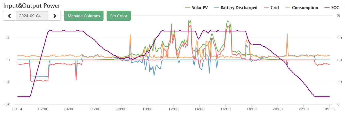

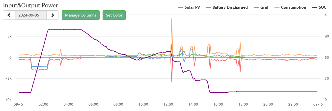

The thing is we only fit solar panels once, so no one can really compare systems. Yesterday was very bad for solar
our main gain was battery being charged over night, but day before
was more typical, the SOC = state of charge, and you can see the purple line showing the dip 5 am to 7:45 am where the solar was not enough to cover all, then around 9 am started to recharge batteries, and by 11 am fully charged again and 11 am to 5:30 pm we exported excess, (9.2 kWh) then dinner caused a sharp drop, and battery ran out at 11 pm. That is about normal.

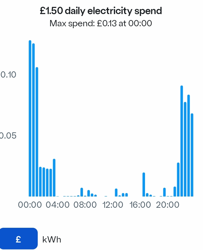

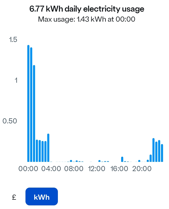

So this is the smart meter app display for same day the 4th 1725615627148.png showing charging battery then nothing used until battery down to 10%. Switching to £ it shows how evening cost a lot than morning1725615873752.png due to the rate change. (£1.50 including standing charge)
