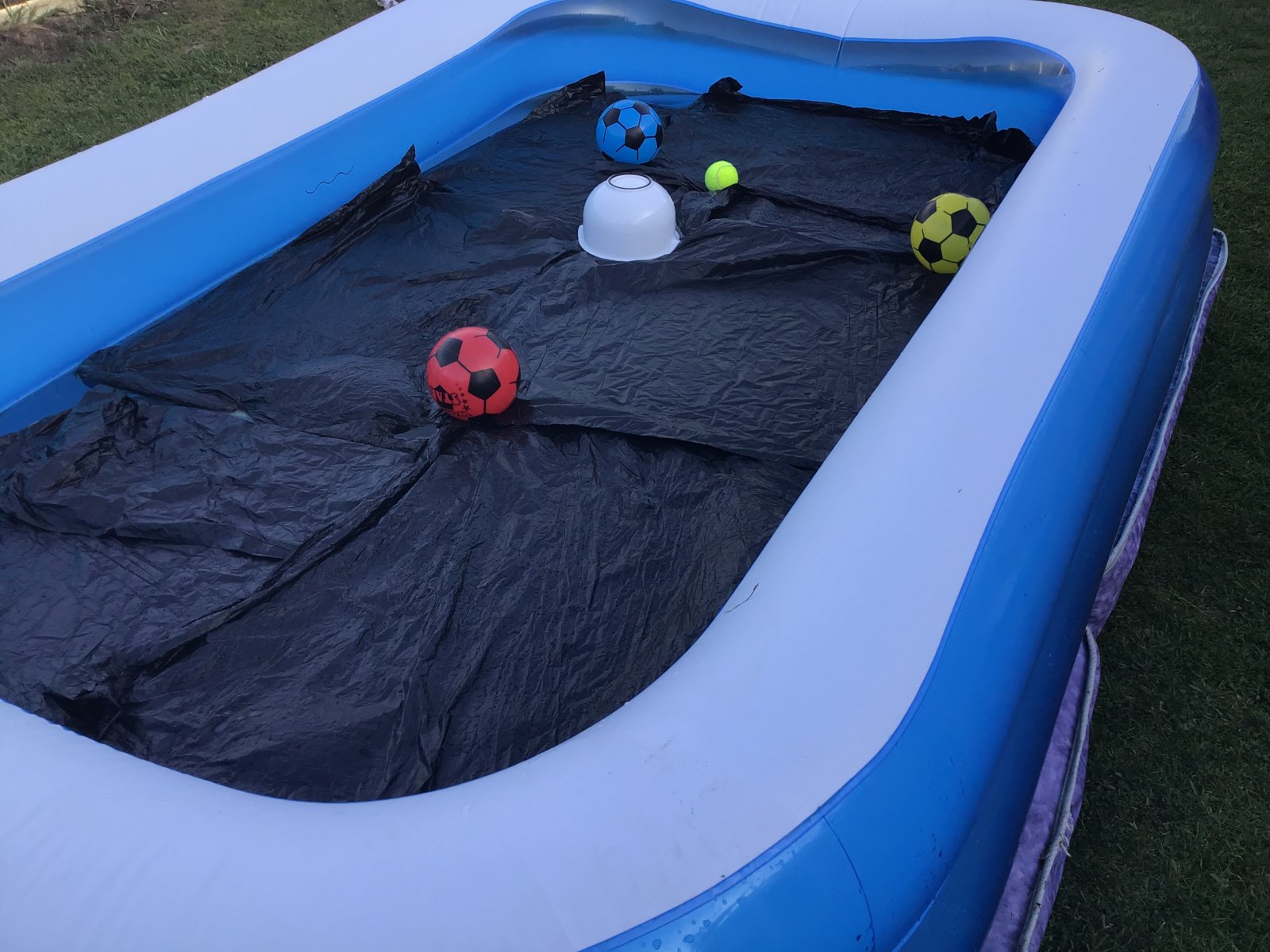

I simply cover the pool with black bin bags you’d be surprised how the sun heats the pool in the morning before I let the kids go into the water. Hope this helps.

I know tried the solar cover option together with recliner sun chairs not a cat in hells chance of getting one at a decent price for the moment anyway. Good luck
Most of these solar covers are like bubble wrap. Could try some of that painted black or with bin bags sellotaped to the back of it!
