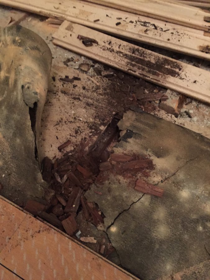

Will try and take some pictures. I was a little surprised to discover what I did. I knew the engineered maple flooring was underneath the carpet but had been led to believe there was a standard timber floor underneath with joists and boards. I thought the maple would be secured to this.
I guess I'm going to have to lift all the maple which covers lounge , dining and hall. Remove the rotten battons and then screed level to the original maple floor level and put a membrane DPC between existing concrete floor and new screed, this would only be around 20-25mm thick though - is that enough?
I suppose I could replace the battons, add a DPC layer and then fix a new board floor to the battons in place of the maple which we'd then have to discard as it would be above a FFL for the rest of downstairs and doors etc.
One pic for starters.....

From the pic above the dark red cuboidal cracked and segmented wood looks like the beginnings of dry rot - probably caused by a lack of ventilation. And maybe damp coming up thro the concrete - does the concrete have a membrane below it?
You should perhaps lift up all the flooring to expose the concrete sub-floor.
Skip all damaged materials.
Use anti fungal chemicals on the concrete surface.
Then use a liquid damp membrane (DPM) on the concrete surface.
Perhaps then lay a screed to whatever height will allow finished flooring to sit on top of the screed.
Maybe some, or all, of the Elm can be saved?

I've no idea what I need to do. The top of the maple is the FFL throughout the downstairs. We are building an open plan new exstension that will have to meet this old floor across an 11m span. I'm trying to get my head around the best way to bring the two together but also ensure the old floor is sound, level and free of any future damp problems.
Quite surprised a 1930's house has a concrete floor so thrown a little especially given the rotten timber and potential DPC issue.
I've no idea yet whether the concrete sub floor has a DPC. May hopefully see that once exstension removed.
Will a 20-25 mm screed on top of liquid or sheet DPC be thick enough?
