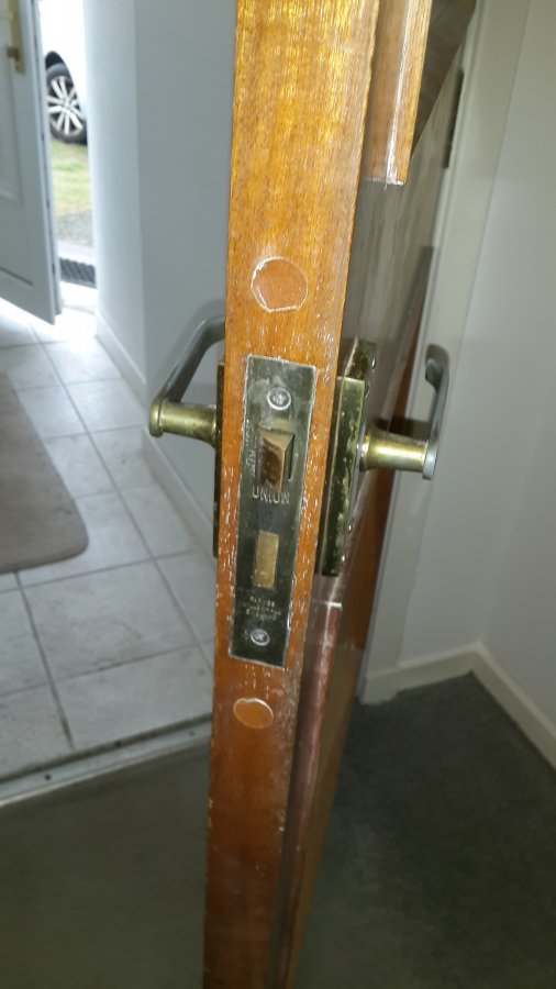

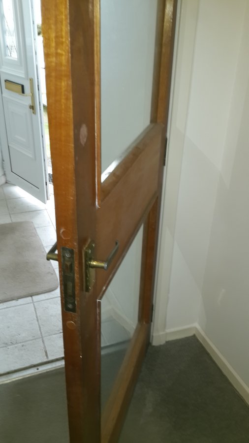

Hi,
I have two front doors in the house; a UPVC outside door and a mahogany/ glass inside door.
The mahogany/ glass inside door is reasonably heavy and it is easy to firmly close it, or, push it hard home (heavy handed users) in such a way that it makes a huge clunk that can be heard by everyone throughout the house.
It has a sprung latch which creates at least part of the noise.

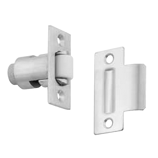

I have thought about replacing the sprung latch with a 'roller latch' to soften the noise contribution from the existing latch.
Has anyone any ideas how to modify the door to make in difficult for someone to make a noise with it.
(I have the same issue with the outside UPVC door being slammed too)

Does the door stick/jam at all? Maybe it needs trimming.

It does not jam or stick at all.

I feel the problem in large part is the latch. In fact I just tried the door and noticed quite a bit of force is needed to turn the door handle down (see picture in first post above) to unlatch the door and open it. Then after the handle is let go of and the door is closed the closing action of the door, as it hits the frame, unlatches the latch, and then, when the door finally sits against the frame in the fully closed position, the latch is released into its resting place as it finds the hole in the door plate. This releasing, with a large spring behind it, is what is causing the massive clunk.
What's been happening is folks are throwing the door, so it has enough momentum to get past the latch opening as it hits the door frame and the latch then finding the hole in the door plate. This is what is causing the almighty racket.

I have thought about using one of these (picture below), but if the wind gets behind or in front of the door, I am not sure it would stay closed. The ones (of these) that really hold doors closed have a strong spring so I could end up back with the same noisy latch clunking problem.

I have thought about using one of these, but if the wind gets behind or in front of the door, it would not stay closed. YES it would.
Thanks Foxhole,
I'm in a very exposed location on top of a gentle hill beside a sea side cliff. There can be very strong winds here. Still stay closed? Yes ,correctly fitted .
