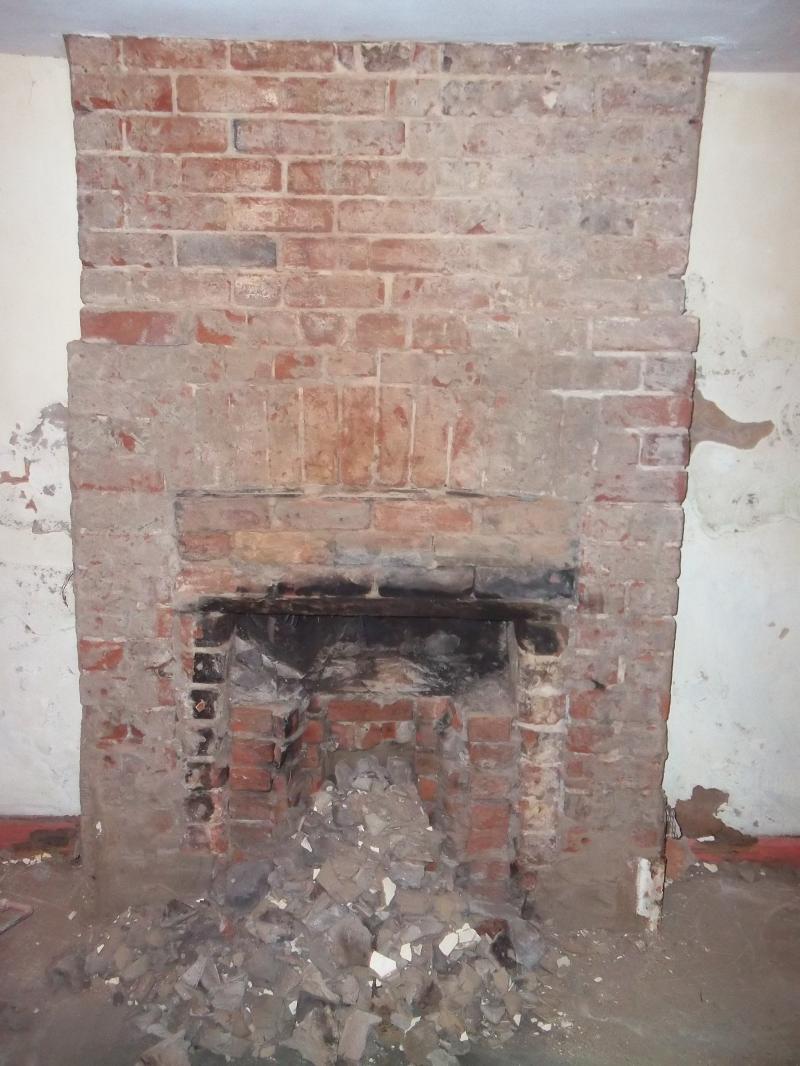

All the old plaster is coming off (damp damaged from being vacant and blocked guttering etc) and we'll remove all back to original brick work. I have already exposed the chimeny breast which looks like this:
we intend to leave this exposed after taking it back to the original arch and supports with either a wood burner or open fire (depending on fundage!).

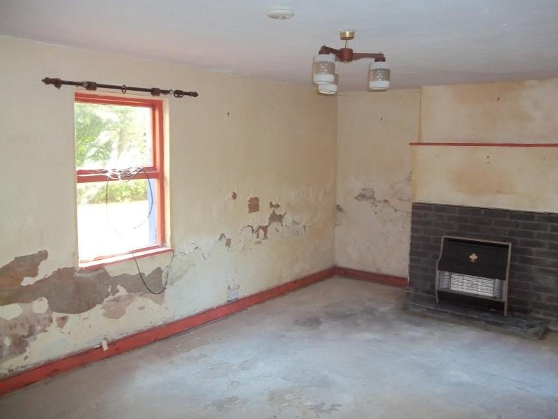

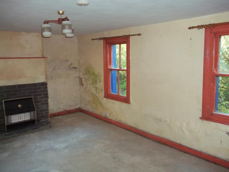

ps here are a few other images of the room before I got hammer happy on the fireplace.

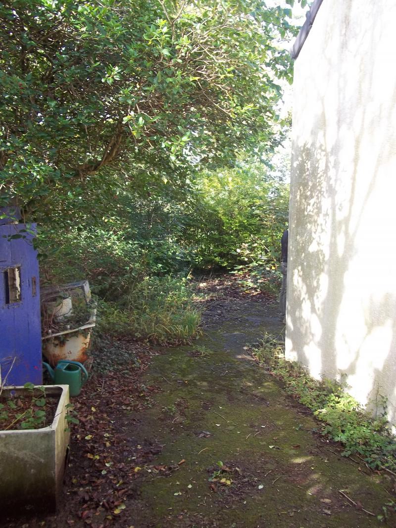

This image (below) shows the gable end of the extension and the external floor levels
Thanks :D

When you have the plaster off i would let the walls dry out and look for remaining sources of damp. It might take a while to dry if some areas are saturated. Sorting the ground levels could easily solve any rising damp issues naturally - cheaper too!
Some would suggest using breathable insulation and lime plaster etc, but that will cost a lot more in materials and time learning the skills required.
I would think carefully before doing anything a damp and timber company recommend as they tend to suggest expensive and overly technical solutions to simple problems that don't address the root cause. And they'll only suggest something from their repertoire, not what's necessarily needed.
It's likley there will always be some damp in the wall, so let it breathe. I would leave a gap for air circulation behind the studwork and have that open to the roof void, it looks like you have cement render outside? If that's the case any damp in the wall will be inclined to travel inwards. With a gap for air circulation, it can at least get out. Making sure the roof space is well ventillated too of course.

A woodburner or fire will look great in that room and help keep any damp out of the chimney breast too.

Perhaps the first thing I would do would be to drop the external ground level by about 12-18", and see if it made a difference.
We did, and it helped for a house with stone walls.
It wasn't concrete, though :).
