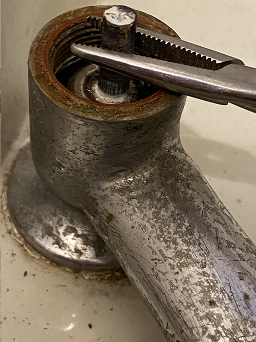

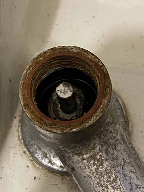

Hi folks. Following my recent thread about my serious problems with unscrewing a bib tap (now solved, by brute force!), I have another problem with the (ancient) tap in the basin just above it.
The basin tap is dripping a bit, so I thought that replacing its washer might be all that was needed. I can't get the ('cross') handle off (and fear I'll break it if I hit it any harder), but I was able to easily unscrew the cover enough to get a spanner on the hex bit of the top part, whereby I easily unscrewed it.
However, I then came across a problem I've never encountered before. Having removed the top bit of the tap, I was confronted with a rod, on the end of which I presile there is the washer) which I simply can't get out. It's 'loose', in the sense that I can freely waggle it about, side to side and up/dawn, but only 'up' for about half an inch until it hits the bit with the thread into which the top part of the tap screws. No matter how much fiddling I do, it simply won't come out. Am I missing something, is this another case in which some sort of brute force is needed, or what?
The first pccie below shows what i can see, and the second with the rod lifted as high as it will go (held up by a pair of artery forceps :) ).
As always, any advice would be much appreciated!!

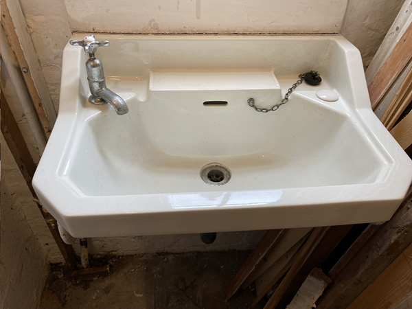

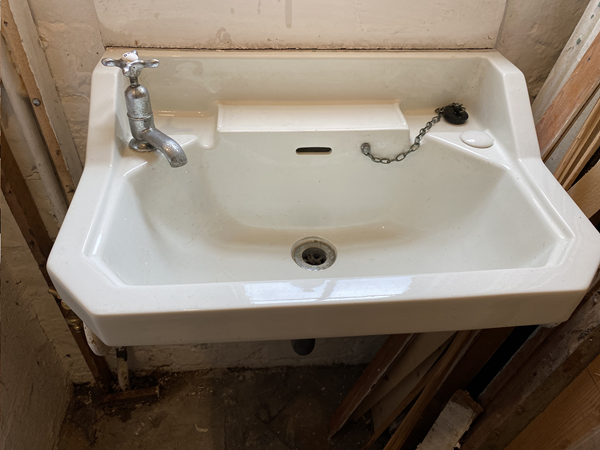

I'm not really sure why you say that. It needs just a little more 'cleaning up', but is essentially in near-perfect condition. I haven't yet decided whether I am ultimately going to use it ('permanently') in the house but, if I don't, there are plenty of people out there prepared to pay very good money for such a thing. I suspect that it is older than even me (;) ), and quite possibly 100 or more years old.
The tap is clearly a different matter, being well past its 'sell by date'. However, there is a lot of 'concrete' in the vicinity of it's back nut, and I really wanted to avoid yet another 'challenge' if I could avoid it, and replacing the washer seems to have achieved that.

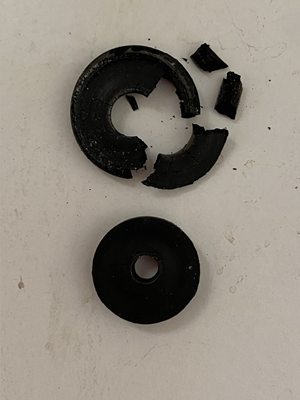

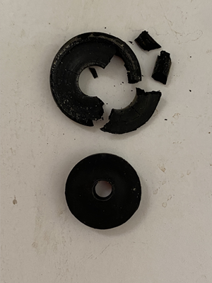

Talking of the washer, what was sopping me getting it out was the washer itself. Over the years/decades it had been 'squashed and expanded', presumably by over-zealous turning off, and had become very hard and brittle. When my brute force eventually got it out, the washer did not bend, it shattered into several pieces - as you can see here (together with an example of what I replaced it with, which did 'fit through the hole!).
