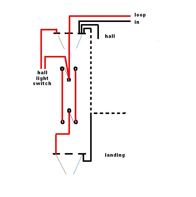

Recently had a bathroom installed in my parents house by a a well known company that begins with a W. All went well except for the install of the downlights in the bathroom.
Board is an MEM 2000 Split Load 16th Ed. and when they moved the upstairs LTG to the RCD would pop constantly, moved both LTG circuits to the RCD and no popping, leading them to suspect a borrowed neutral. No further investigation was carried out.
I have done some investigation and am unsure if they are correct as a borrowed neutral is not something I have come across before. (I'm only partly qualified/in training).
Each MCB in the C/U has two cables and the previous sparks have identified 4 neutrals to go with it. It seems one T+E from the downstairs MCB simply supplies the under stairs cupboard so this is easy enough to identify and exclude from the problem.
This leaves me with 2 x T+E (1 per LTG circuit) and then two singles+earth. One is a N+E and one is a L+E.

Why are there so many neutrals in the hall light rose?
Anyone?
This is why I'm thinking the single N+E is actually on the D/S circuit - god knows why so many Neutrals though, I did raise my eyebrows when I took the cover off
Is this a dead give away of a borrowed Neutral?
Well, if the landing rose neutral IS on the upstairs cicuit then there is also an extra neutral in the hall rose.
However, if the landing rose neutral IS the extra neutral in the hall rose then it may not be a borrowed neutral (at least not here).
May help ???
Edit - I have made a mistake in thinking the two roses pictured come on together - of course they don't - but I will leave the diagram as it may help you think of something.

Since I can see one link wire I will guess you have the two wire strappers for the up and down stairs two way switch which does equate to a borrowed neutral.
Years ago it was common to instead of running three wires (Plus earth) between the switches to just run 2.
the two way switch arrangement shown has a line wire shown as brown here which takes the line supply to both switches by linking the line from another switch in the switch block one can get away without the third cable.
However this results in a induction loop being created which can put mains hum on radios etc. As a result the practice was discontinued.
However it works OK (except for hum) as long as the two switches are supplied from the same MCB. However as people started to put up fancy lights the load exceeded the 5 to 6 amp that the ceiling roses are rated at so the common practice was to split the two supplies. Although really a borrowed line it is technically know as borrowed neutral.
However before the RCD likely no one was aware that the situation existed. So now you have two ways to get around the problem.
1) Run a new cable between the 2 two way switches with three cores and earth.
2) Return to using a single MCB for all lights.
The latter will likely still produce a mains hum when switched in one configuration and will also mean all lights are on same MCB. But today with energy saving lamps the lighting load has been reduced so likely there is not problem.
However having the lights and sockets for any room on the same RCD means should a RCD trip both table lamps (plugged in) and ceiling lamps could fail together which could according to house design produce a danger. This is down to a risk assessment but could mean you need some emergency lighting is key areas. Or run the lights of it's own RCBO so they will not trip with the sockets so in problem areas table or standard lights can provide light from an alternative source.
