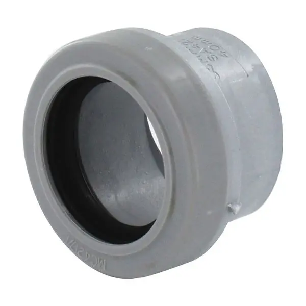

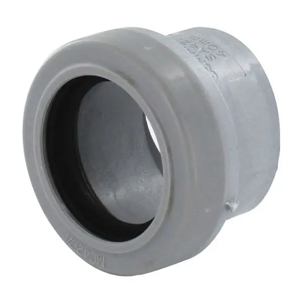

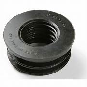

I presume the pipe runs into a strap boss at the moment? You say they are leaking, do they have rubber reducing bungs or do they have glued hard shelled push fit reducers?

Normally the boss adapters leak because the pipe into them isn't lined up or has the correct fall and the waste water then tracks back along the pipe. They can both be serviced, the former's seal can be replaced and the latter can just be swapped for a new one which will avoid having to replace the boss'

Both run into a boss strap currently. The pipe connection from the wash hand basin looks similar to the grey one on the left image above. The other one from the bath has a screwed connection where the pipe joins into it and looks similar to the image below.
Neither seem to be leaking from the part where either of the pipes join the boss straps. Both appear to be leaking from where the inside face of the curved flange (shown on the above image) is fitted against the soil stack. The whole installation does look quite old and attempts do appear to have been made previosuly to patch them up but not by me, so the previous owner presumably had an issue with leaks and tried to seal them rather than replacing them with new.
I cannot see if either of the boss straps has a rubber bung in them.
If the curved flange on each boss strap has been solvent welded to the soil stack, how do I remove them without damaging the soil stack?
