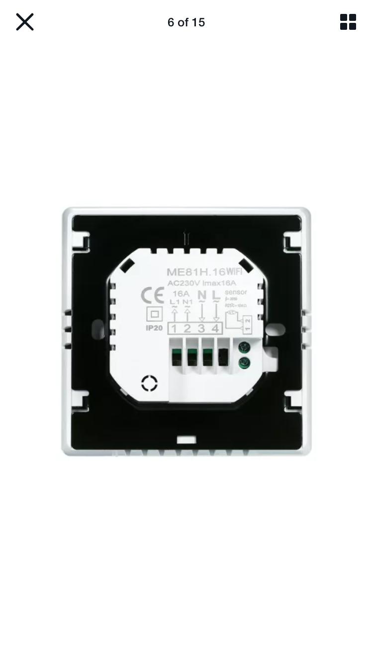

2 x Chinese (PICTURE) 4 wire 16 amp thermostats that replaced......

Chinese 4 wire 16 amp mains supplied thermostats do not trigger boiler/actuators.
Wiring from Honeywell T6360s: earth, 2 neutral, 3 switch live, 1live (PICTURE)
Wiring Chinese: L live, N neutral, L1 live loop, N1 switch live. Thermostat displays correctly. However manual temp does not trigger boiler/actuators.

From old Honeywell T6360 to Chinese thermostat
"2" Neutral (blue) to "N"
"1" Live (red) to "L"
"3" Switch live to "N1"
I put a loop wire from "L" to "L1" to power switch
you are a wire short for your cheap chinese crap, it needs a permanent live in to L
Isn't...
"1" Honeywell Live (red) to Chinese "L"
permanent?
It's permanent live or the digital display wouldn't remain on. It's the L1/N1 – call for heat that I'm not sure about.
L1 gets a loop of mains power from L. N1 is the switched live. In both the 6360s it worked. Now in the digital thermostat it doesn't call.
How do you know it was wired correctly in the Honeywell?
L1 is the switched live there should be no connection to N1 in your situation.
So
Red to 4
Blue to 3
Yellow to 1
Nothing to 2
Cheers, that worked a treat. Decent quality thermostats at a sensible price.

Yes the diagram wasn't clear that the neutral (N and N1) was jumpered. It was and I could go straight from L1 with switch live (tried to loop hot wire). I had assumed the blocks were separated. Luckily I didn't wreck the thermo.
