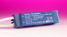

As @Taylortwocities says, the old power supplies are likely switch mode like this 1728367221251.pngand this
where it says (20-60VA) means it needs a 20 watt load, these

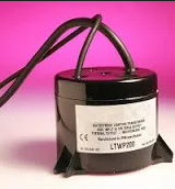

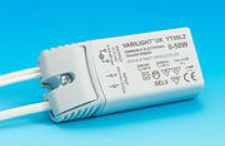

old toroidal transformers will work OK with LED, so if round 1728367561920.png likely OK, new transformers 1728367619137.png will work, today they will likely say 0-50 as the one shown, but even then there is some old stock around.

Often as long as one lamp is halogen the old power supply will work, so you can swap the odd bulb to LED, but normally not all unless really old.
