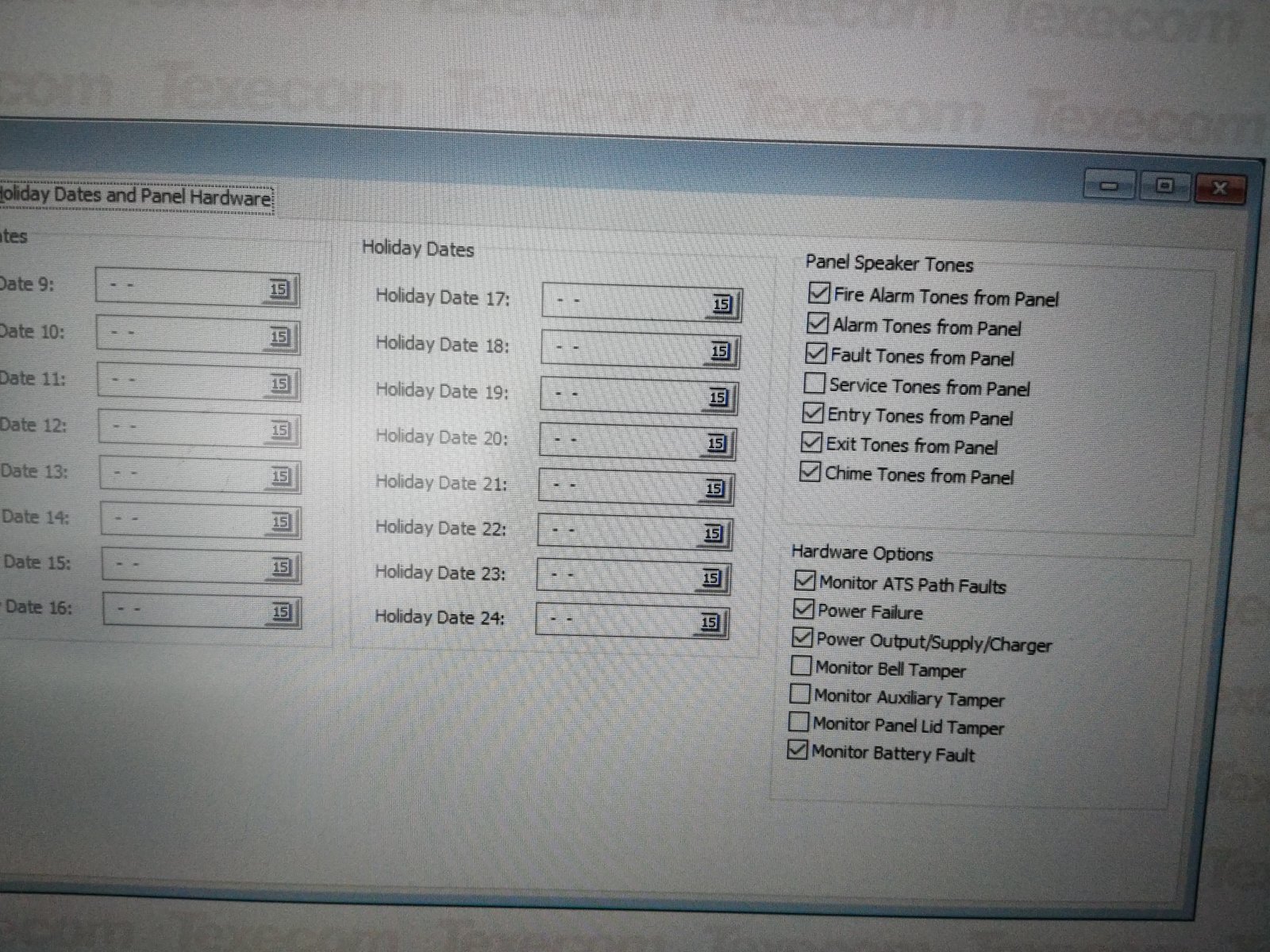

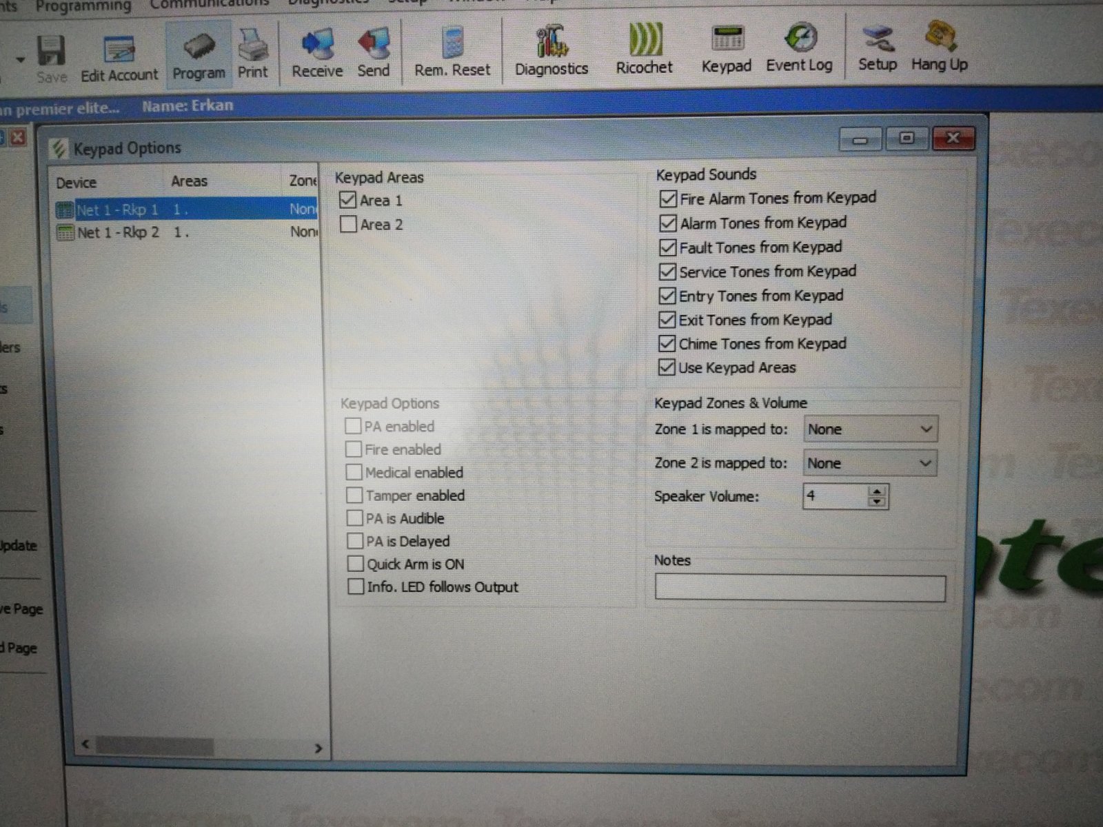

I thought the wired keypad would give a alarm sound when the alarm would be triggered. But it won't give a sound automaticly, only after a i press a key after a sensor is trigger it makes a. Alarm sound. Not very useful :)
So i have 3.question guys:
1) can i change anything in the settings so that the wired keypad will inmediately sound if one of the sensor's are activated.

1 it should ( check keypad tones )
2 yes
3 probably not as the internal wireless part will be old ( check green sticker on wireless part )

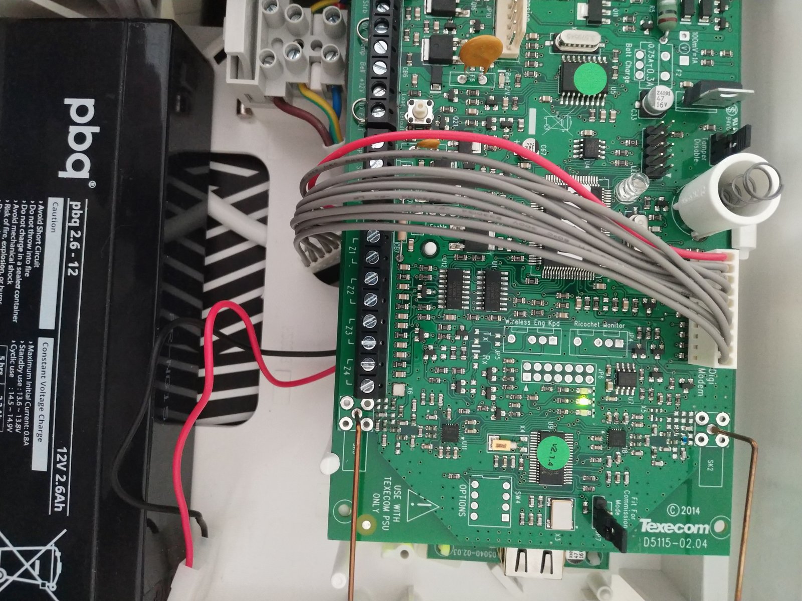

Did you check the version of the built in wireless expander, if you cant see the green sticker on the wireless half of the panel.

There are 2 green stickers on the inside, one with the text v2.1.4 on it.
The 12-w panel has does not have v5 software, lastupdate is 4.00.
Version 3.1 on the wireless needed to have keypad yours is 2.1.4

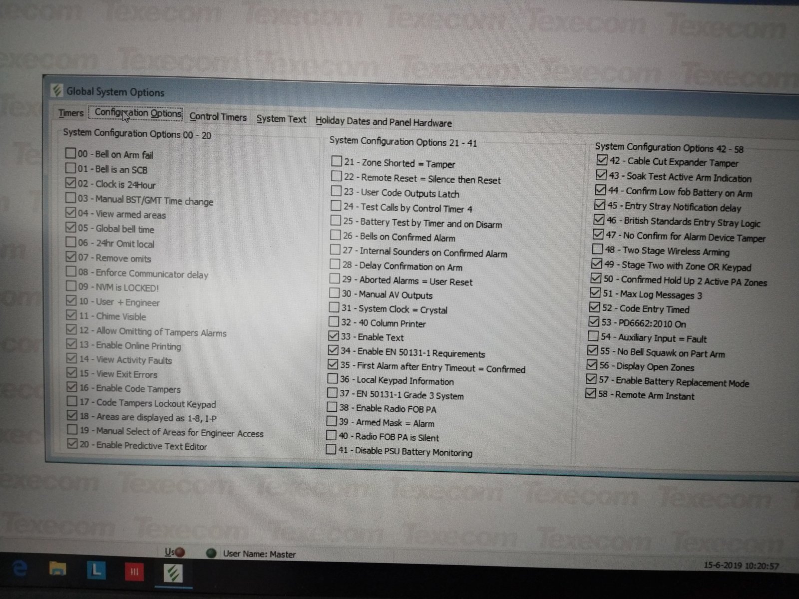

Have you changed any setting via wintex ? As there a few non standard ticks e.g. Monitor hardware ?
Yes, i might have clicked a few changes :)

Well ı did send a message to texecom. They are very friendly and willing to help. They found the solution for my problem. The CodePanel was adressed at adress 6.
But this old elite 12-w can only manage 2 CP's MAX.
solution was to take all adress pins on the CP down, except the pin of adress 1.

two different things being discussed, the point I was making and sparkymarka is that you need a new panel anyway for the wireless keypad to work properly,
your saying you had changed the address switches to an invalid address hence that solved your issue...….
