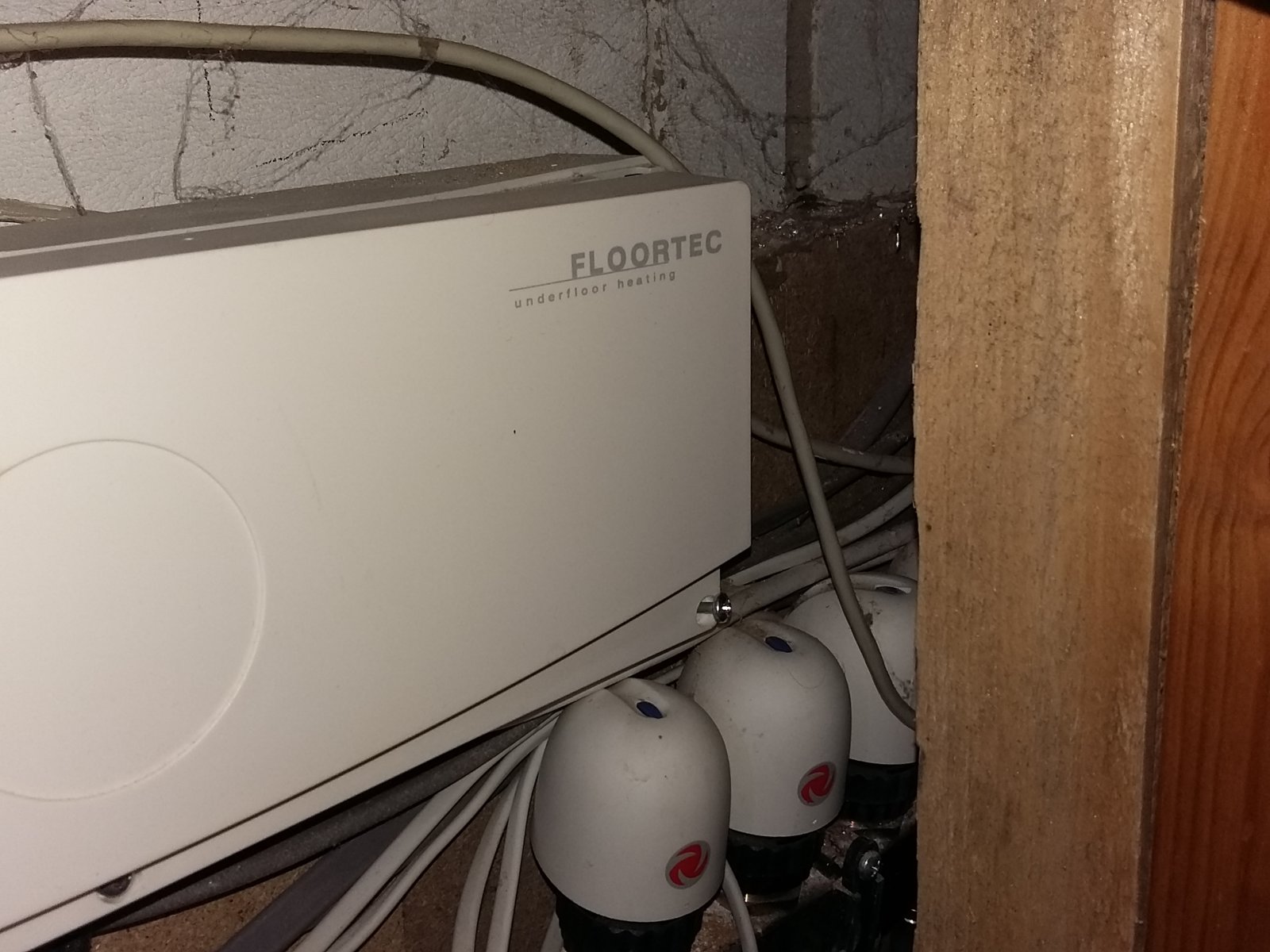

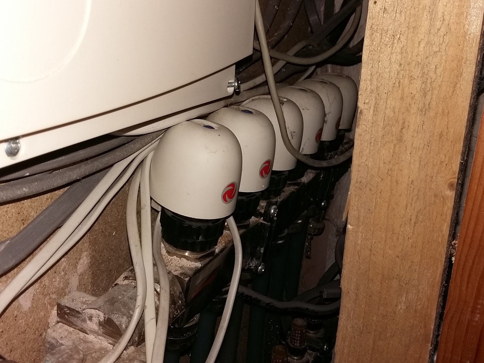

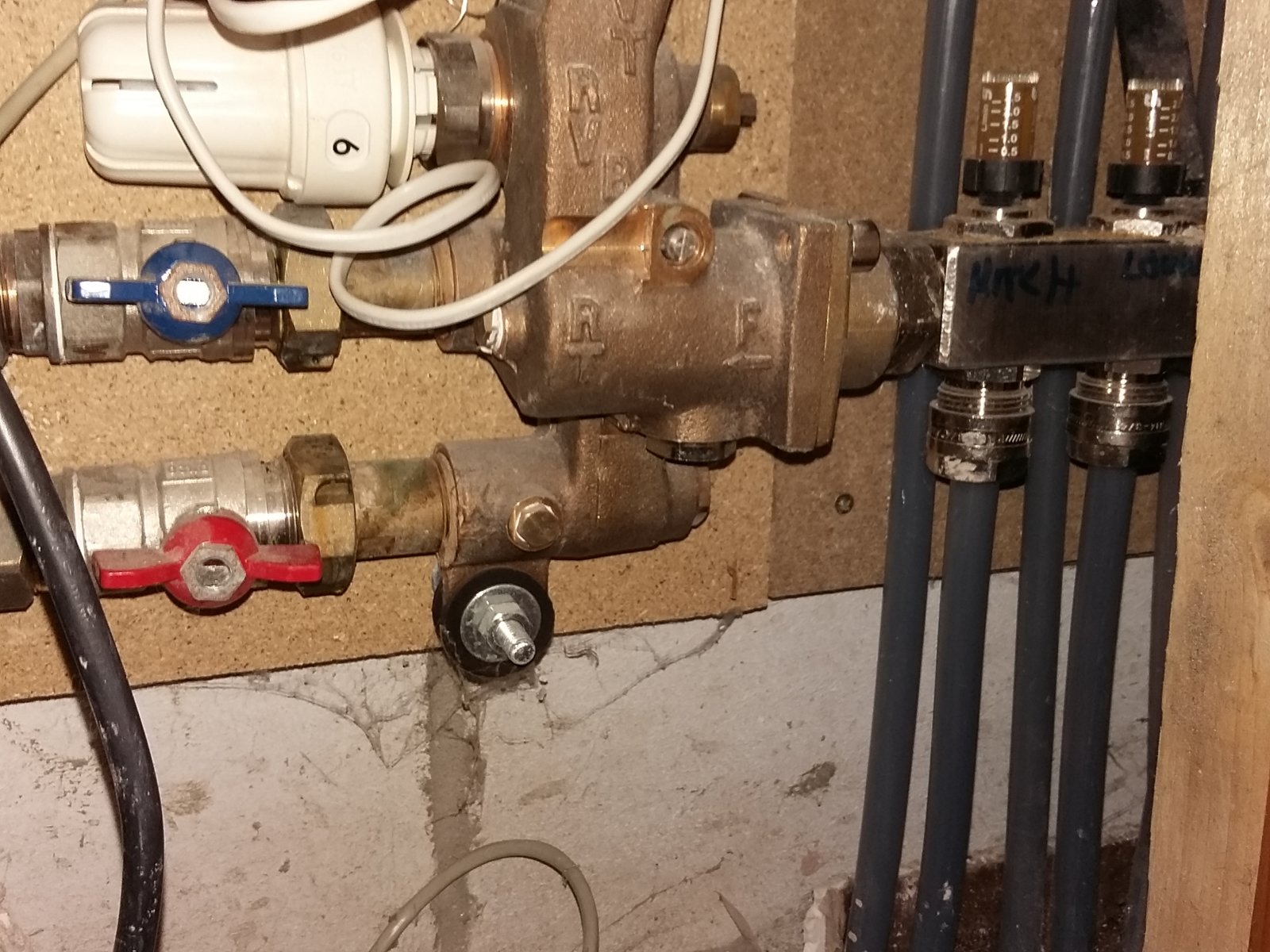

There is an upstairs UFH manifold and a downstairs UFH manifold.
I have have added some images of the downstairs manifold....not tidy.
There are 5 thermostats downstairs.

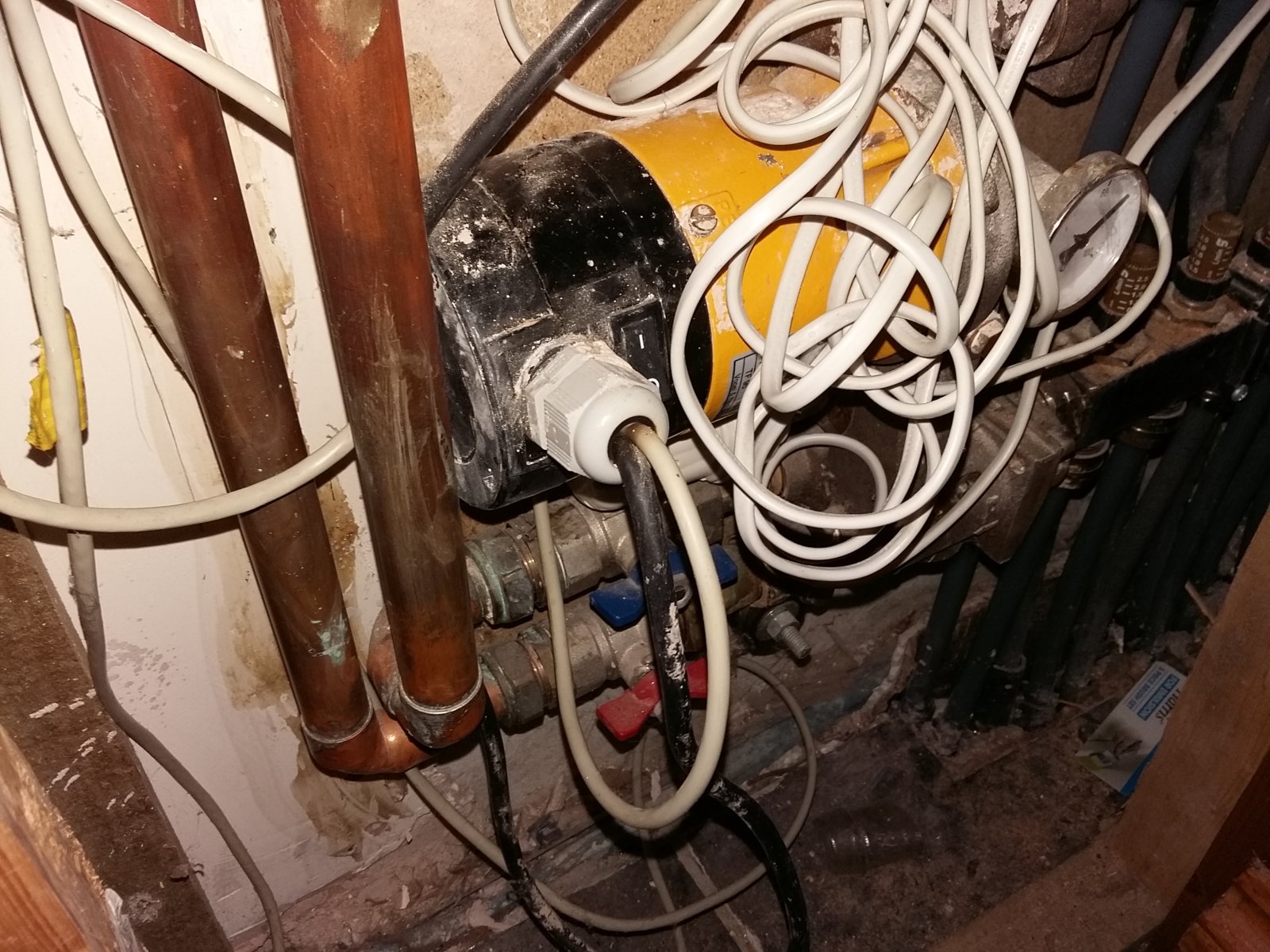

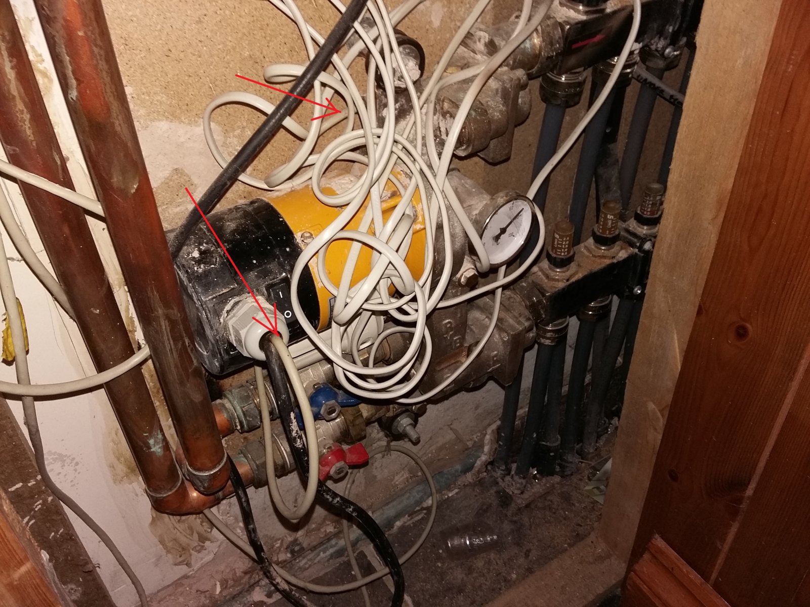

If we set the programmer for CH 'On' and 'call for heat' on one of the thermostats then the Drayton valve opens, and the pump on the manifold runs. The flow pipe to the zone gets hot so all appears to be good, but we notice some time later the manifold pump is not running even though we are still 'calling for heat' on the room stat and we have mains going to the pump. Definately 230 v on the black cable going to the pump.

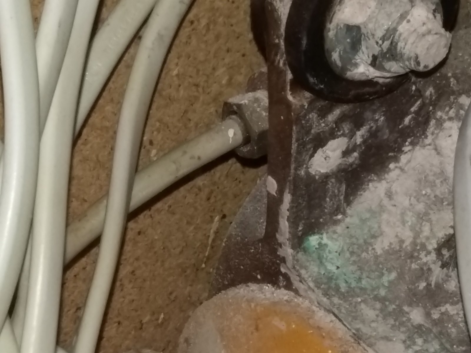

Seems simple but we are unsure of the purpose of the second wire going into the pump. It comes out of the manifold, see red arrows on image.
It may well be this is fine and working and I have yet to see it in a non working state.
