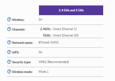

Hi Lucid,
Followed the link and it looks like my router has set channels already and not on auto as the Sonos page recommends. Any ideas please?
Apple and BT are the two biggest causes of headaches for me and my customers who use Sonos and other wireless or networked devices.
BT sell their SmartHub on the idea that you'll get great network and Wi-Fi performance. Whilst it is a better router than most ISP-provided boxes, it gets a bit too big for its boots sometimes.
From what I know of the set-up, I think that the 'Smart' shown in your screen grab (thanks for that, BTW, very useful) is BT's smart channel setting feature. In other words, the router is scanning the 2.4GHz channels looking for the least congested area and then channel hopping. Some devices can cope with that, but others prefer a stable channel relationship.
Have a look at this page which details making changes to the way the various generations of BTHubs handle 2.4 GHz Wi-Fi. Fix the channel to 1, 6 or 11. You might also want to play around with the wireless mode if you're still having connection issues. See here for details.
Should you still be experiencing issues accessing music from the laptop then the next stage is a temporary test using an Ethernet connection between the laptop and the hub. This will eliminate the wireless connection from the laptop to the hub which will then tell you if it's a BT/Sonos wireless issue, or a BT/laptop wireless one.

I'm going to re-scan channels now and then if that doesn't work i'll hard wire the laptop to the router and try that. Don't fancy going to mode 2 as some of my devices struggle for signal already and it looks like they lower the signal strength!

Switching to Mode 2 on the router wouldn't make the Wi-Fi any worse for that laptop; and it may even improve the reliability of the connection.
Connected the laptop via an Ethernet to the router and worked perfectly so it’s clearly the connection between the laptop to the router.
I’ve set the router to mode 2 now and tried the laptop but it still stuttered!!!!
