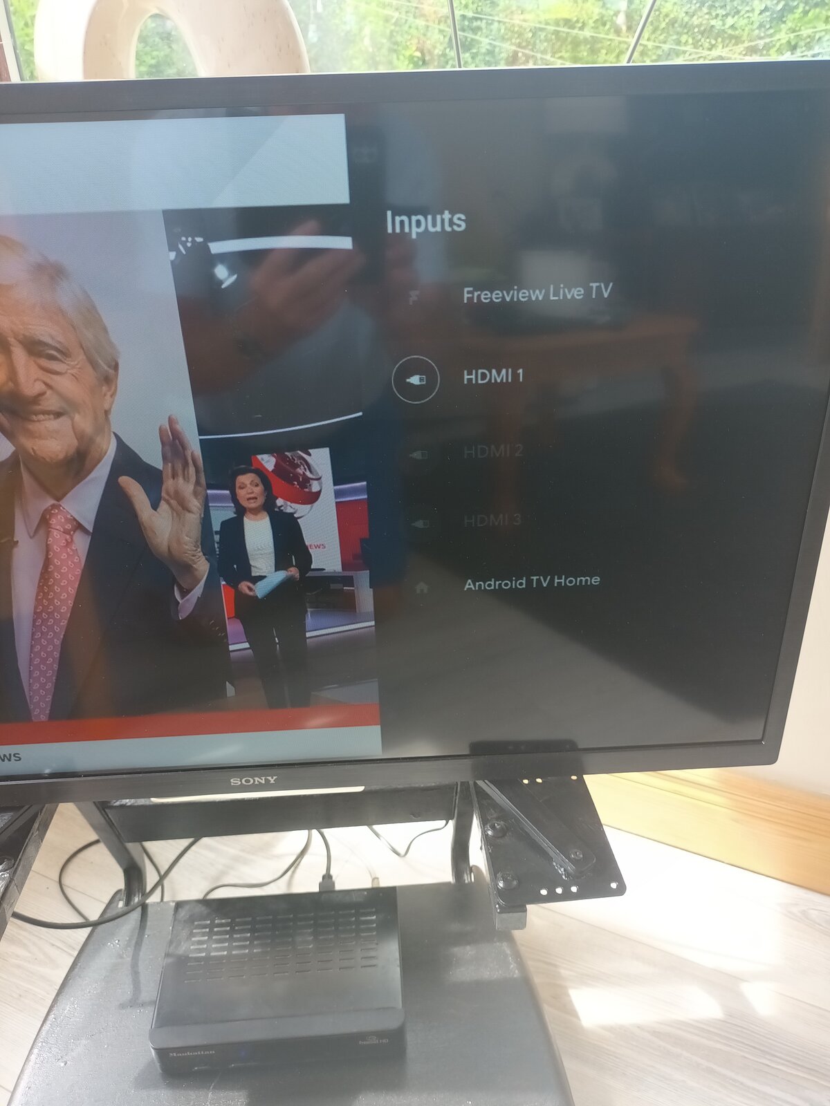

Bought one of these recently. it has a Freeview tuner, I also have a external Freesat box. I have my (rabbits ears) Antenna plugged into the TV socket and the Freesat box into the TV HDMI1 socket, the Satellite cable is plugged into the Freesat box. The TV "sources" show Freeview Live TV, HDMI1, HDMI2, HDMI3 and Android TV Home. Works fine as set up, after a Antenna scan, I just select HDMI1 (via the Manhatten box) for my Freesat stations and select Freeview Live TV which gives me the usual Irish channels known as Saorview.
If I connect the Satellite cable into the TV port (with the antenna remaining in the TV socket and I change the TV tuner from antenna to satellite and do a scan on my usual Astra2 28.2E, to get all the free to air channels but I lose Saorview (Irish chnnels) that I had via the antenna tuning. In other words can I have both the Satellite channels and the antenna channels available together without using a external box, are there two tuners in this TV?

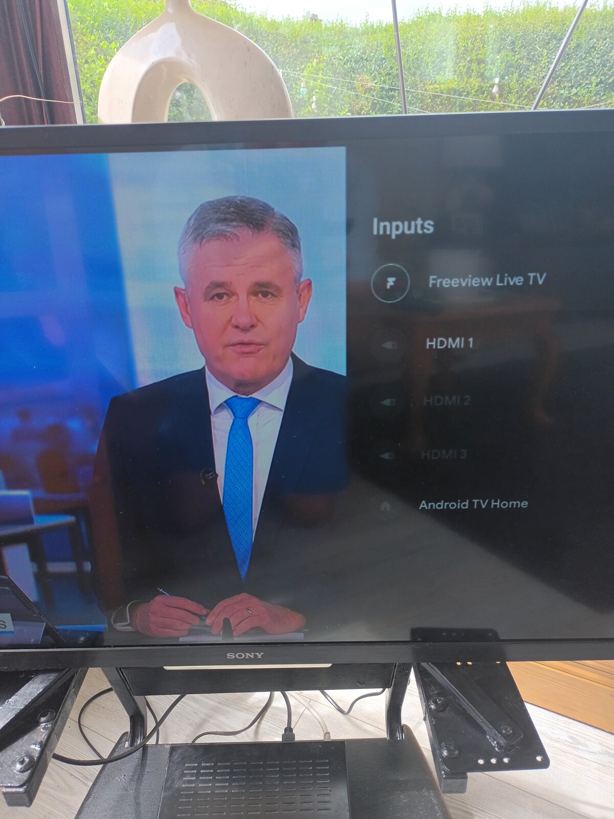

What I can say for certainty is that it will provide Saorview OR Freeview depending on which one I've scanned last, when I go to source you can see whats displayed in the screen, the first photo, "Freeview" shows HDMI 1 selected (highlighted)so I get the Freesat channels from the Manhattan box, the second photo, "Saorview" shows Freeview Live Tv selected (highlighted) which gives me Saorview because it was "antenna" scanned.
If I remove the F connector from the manhatten box and insert it in the TV then I will still get saorview from the Freeview Live TV, but if the last scan was from the satellite then i will get Freeview, there may be some "menu switch"?
