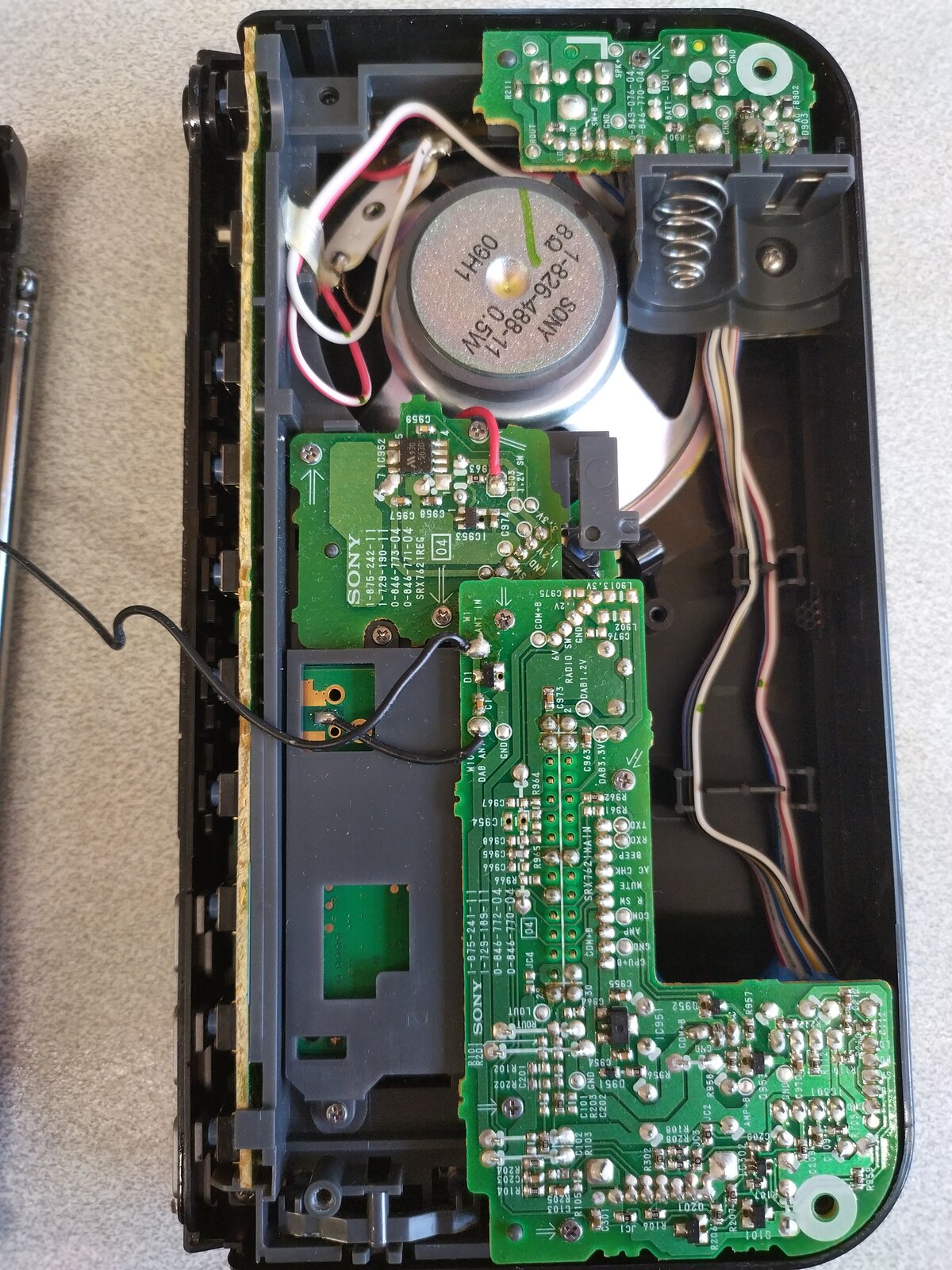

It started playing up. Sometimes all stations go off-line, sometimes most go off but a couple stay.
I can't work it out. The problem is the same regardless of which room it's in or whether I'm outside.
It says either "NO DLS" or "NO ENSEMBLE", so I reset the button in the battery compartment. Switched on and it said "INIT", then "NO SIGNAL".
Now I get bugger all!
I think it's forked. But before I throw it away, has anyone any ideas?

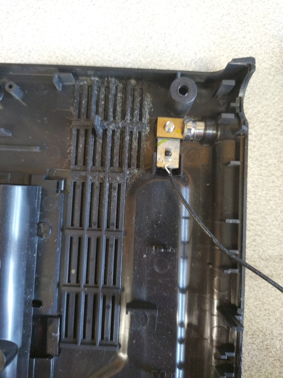

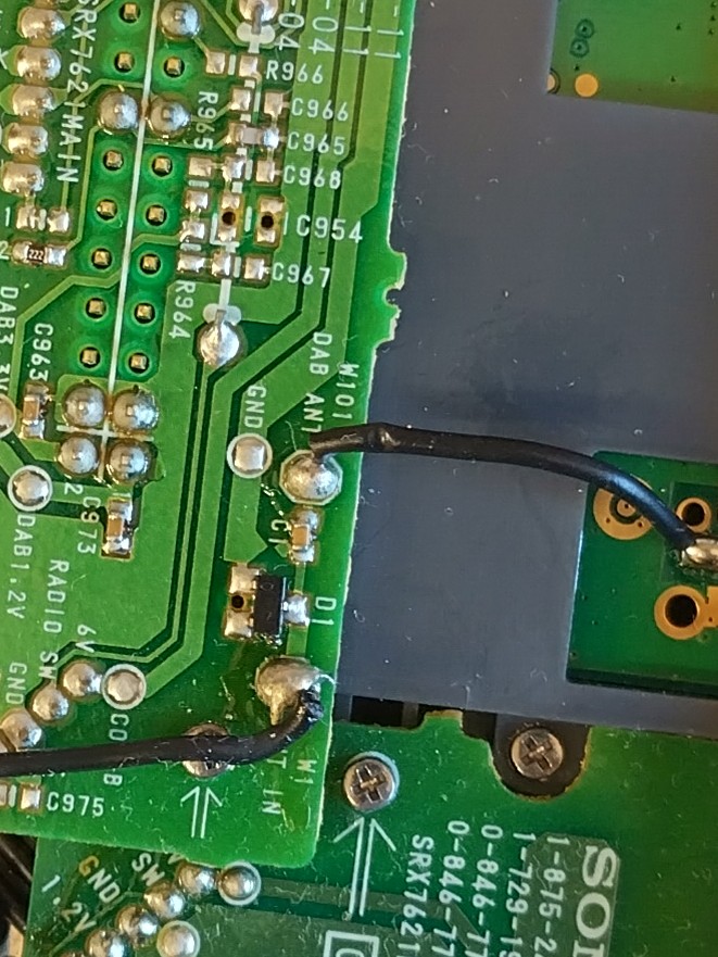

I can't see anything immediately problematic.

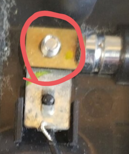

Neither can I, though I just wanted to check - is the antenna riveted through here?..
And it may be a trick of the light, but has the wire been trapped against the PCB here?...
The antenna is screwed to that, and it's tight.
The insulation on that conductor is a bit squashed, but not broken and there is continuity between those points.
