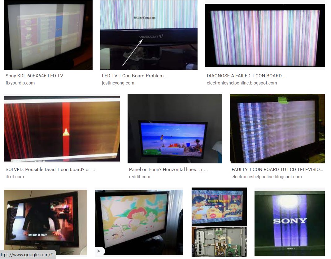

Hi,
Our TV which is a Sony KD-43XE8396 has suddenly started display only vertical lines. The lines are some form of corruption of the picture as the change if you press buttons or channels. Sound comes through OK. The symptoms are unchanged if all inputs such as aerial, HDMI etc are disconnected. I've tried various sorts of resets as documented, including holding down "On" and "-" on the TV while connecting power, and the reset process initiated by holding down the soft power button on the remote.
Any ideas, or is it simply knackered? I think it is between four and five years old, and I can't remember the warranty period but have logged with Sony anyway.
Screenshot of the issue ...
Most likely a failed T-Con board.
Modern LED flatscreen TVs have very little inside other than the screen, and the backlighting system, a power supply and a couple of signal processing boards. Replacing a T-con is about one step further on than replacing the toner cartridges in a printer. Youtube has tutorials. Parts available from eBay usually.
Thanks. I looked at some of those tutorials and blogs, and it seems like a "t-con" related problem can be either a fault within the panel, or the t-con board itself. There are various things showing blanking off individual clock lines for example. However I didn't realise a replacement board would be so cheap, so I'll just try that and see. Will move the TV somewhere I can dismantle it without damaging it, getting in the way or losing parts.
