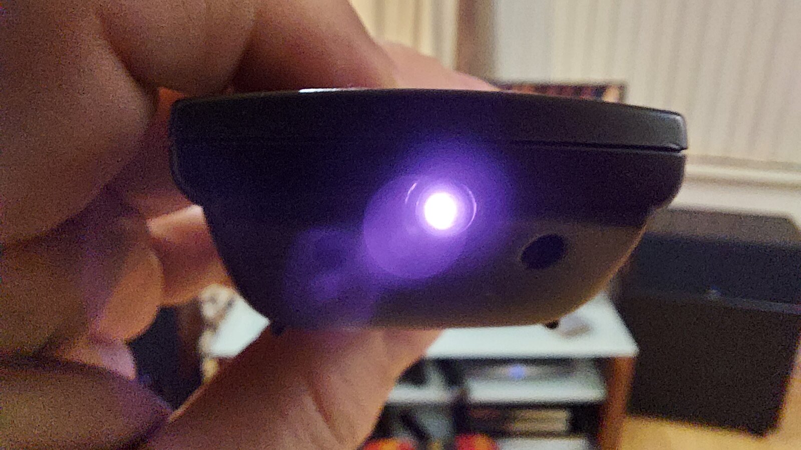

If you followed the video, and the VM box detected the Sony TV, then offered codes for it from the onscreen display, then the issue is either the button sequence isn't being followed correctly (dodgy button, perhaps?) or the remote needs to be reset, then paired again with the box first. This is a version of "switch it off, then back on".
Sony uses a fairly small set of IR commands for the core features of its TVs. There's some variation because of different features between successive models. Look up the remote reset procedure, then go through pairing the Virgin remote with the Virgin box. Before you try the code thing again, take your phone and put into camera mode. Next, point the remote at the camera so you can see the image on the phone screen. Press each of the buttons and see if you can spot the IR remote's emitter flashing. Try each of the buttons that you will use in the programming sequence.
