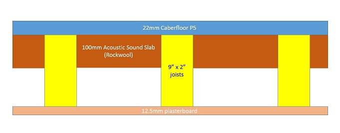

Simply put, in our recently completed extension we can hear noise transmitting between the floors very, very clearly. People chatting, the noise of the curtains being drawn along a metal curtain pole sounds like they’re in the same room etc. This ground floor room itself is a large (approx., 32ft x 12ft) single area so I’m not sure if this is creating some type of amplification. In fact, the sound actually feels like it is coming through the wall cavity!
The construction did bear in mind some noise abatement measures, namely 100mm acoustic sound slab consisting of Rockwool in between joists. The floor itself is 22mm caberwood and the ceiling below is 12.5mm plasterboard. We also laid extra thick carpet and underlay to the upper floor.
Our builder is flummoxed, the structural engineer can’t see any issues with the build spec. and our planning officer popped in and was confused as to the ‘why’.

Thanks both.
Chappers - I've contacted Hepworth and awaiting a reply.
Ken - As you'll see the cross-section already has a sound slab in the form of Rockwool but I see what you are saying with the introduction of Quietex. Similar in theory I'd guess to a suggestion I once received to use sand in between joists. Sadly, with the extension fully finished it woujld be difficult to execute without major distruption.
BTW, I'm beginning to think this is more a 'flanking' sound issue.
I bet its flanking sound, that is sound coming down your internal walls because they are lightly constructed. I have a similar problem, bathroom above kitchen, the only sound you can hear is when someone slides along in the bath, resulting in a squeaking sound. Can't hear people on the loo. I packed 6" glassfibre very tightly into floor cavity. Did your builders do that with their insulation. Any small air gap makes a huge difference. i.e. if insulation is not overlapped at joints.
