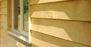

I am building a small workshop in my garden and have started a thread here.
Before I start laying the walls I need to know what doors and windows I am going to fit but I am having trouble trying to source them.
The shed will consist of a block wall about three course high painted cream to match our garage) on top of which will be a wood clad frame and a grey fibreglass roof similar to the pic below.
I would like a door similar colour and style to the one in this pic to suit the walls:
Also looking for a window in the same style as the door.
I'd like UPVC or an external wood door.
Any ideas where I could get these from? I live in North Devon.

I may of misunderstood you when you said 3 courses will be block, I assumed the rest would be timber studding with cladding as per your picture, if it's all going to be block work and then clad albeit from 3 courses up then order a standard door frame and fix into the blocks as normal, even if it were studding you would use 3" wood screws through the pvc into the timber.
Set the door back so the inside frame is flush with the inside of the block work, the outside will need to be finished with cheeks like this.....

No you didn't miss understand its me confusing you. The lower part of the shed will be three courses of blocks and the a timber frame will sit on top of this to make up the upper walls of the shed. Only the timber frame will be clad with T&G not Featherboard.
So the door will sit back in the door recess flush with the inside of the block work with trim around the outer edge covering the block, timber and cladding.
Yes sit the door back so the inside is flush with the studwork and screw direct into the studs after squaring the door frame up, then form some cheeks around the 3 sides to which you will butt up your featheredge boards up to as in my first picture above, the bottom of the door will have a 150mm deep cill so won't need a cheek
