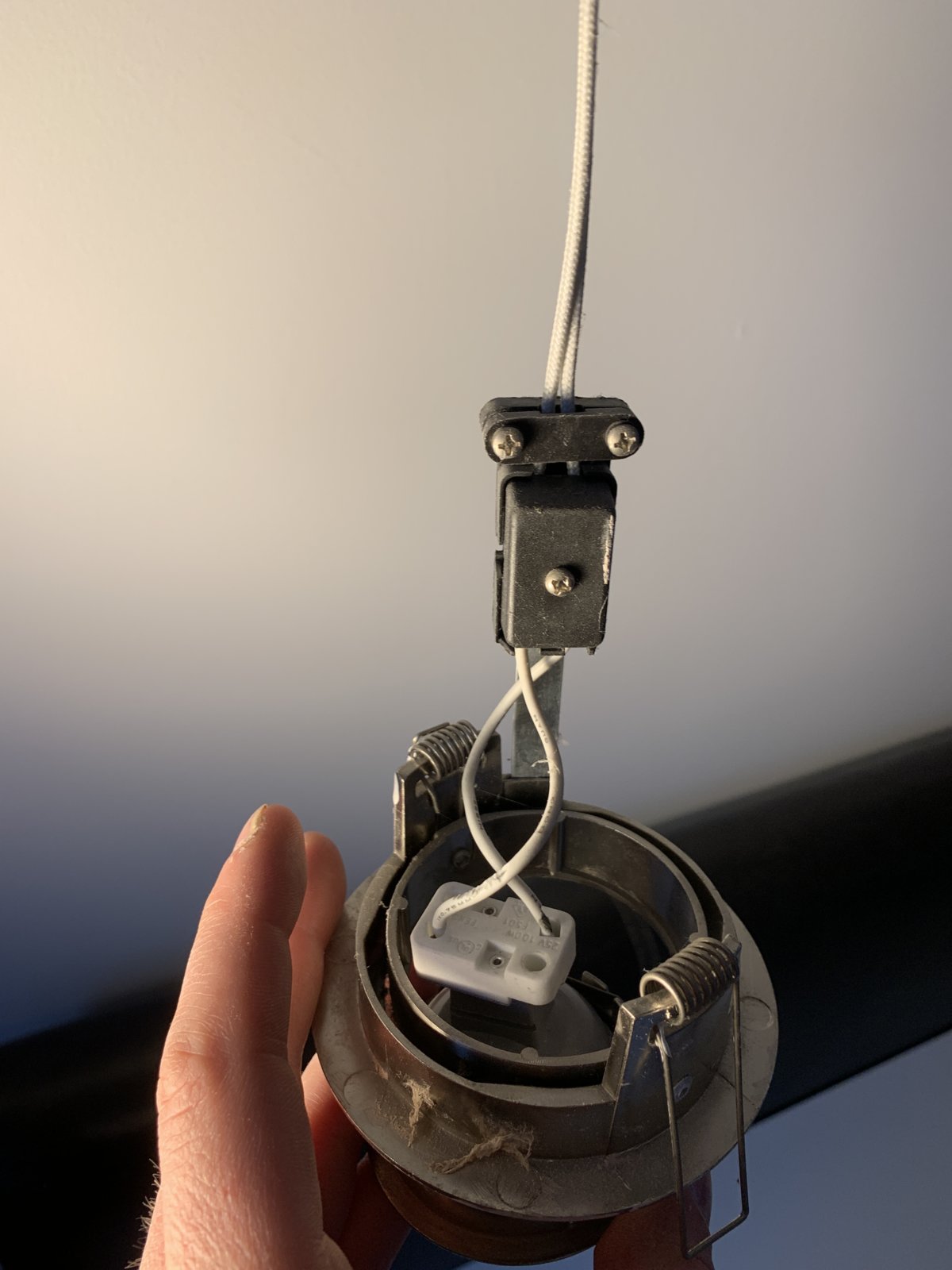

My house is filled throughout with the same down lights:
  • a steel recessed ring labelled “Emcolite GX5.3”.
  • A bulb holder, ceramic labelled 25v 100w.
  • with a small black connection box containing a choc block and a steel strip (bridge) to fasten the box onto the ring.

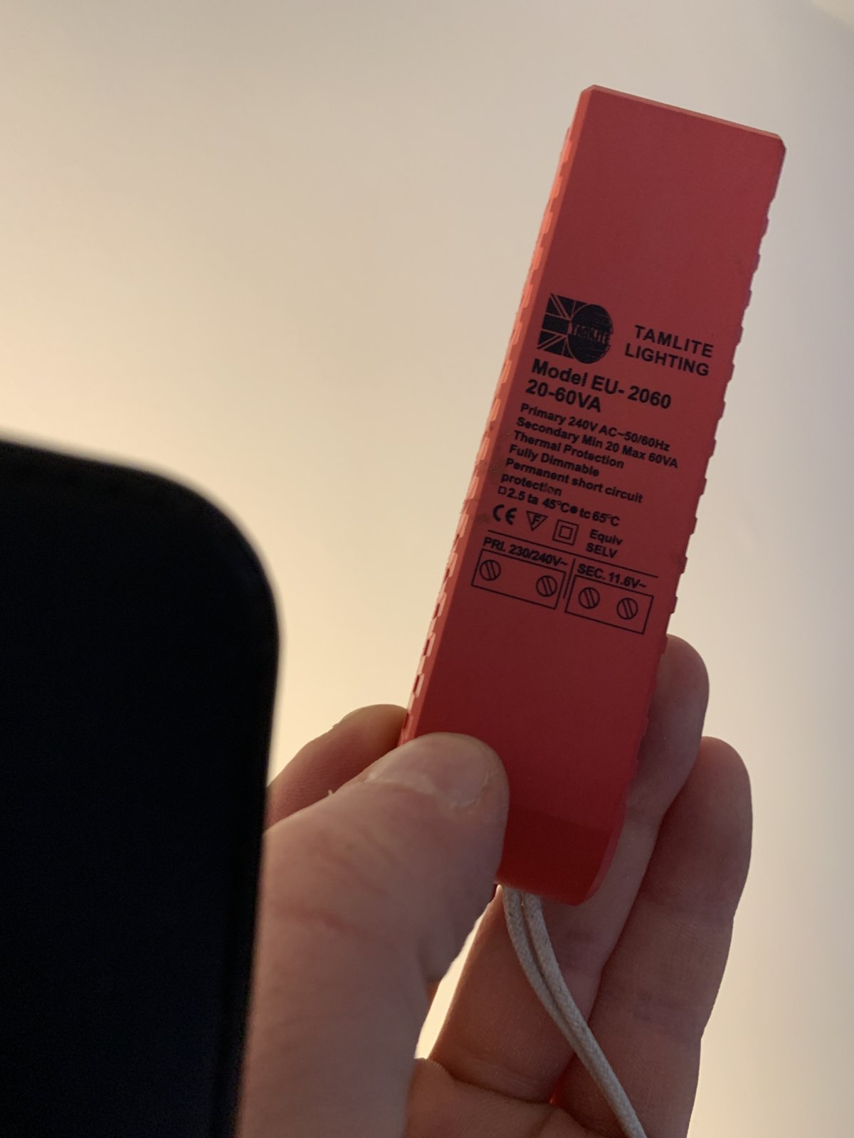

  • A transformer labelled “Tamlite model EU-2060 20-60VA” which is connected to a standard junction box connecting to the lighting ring.

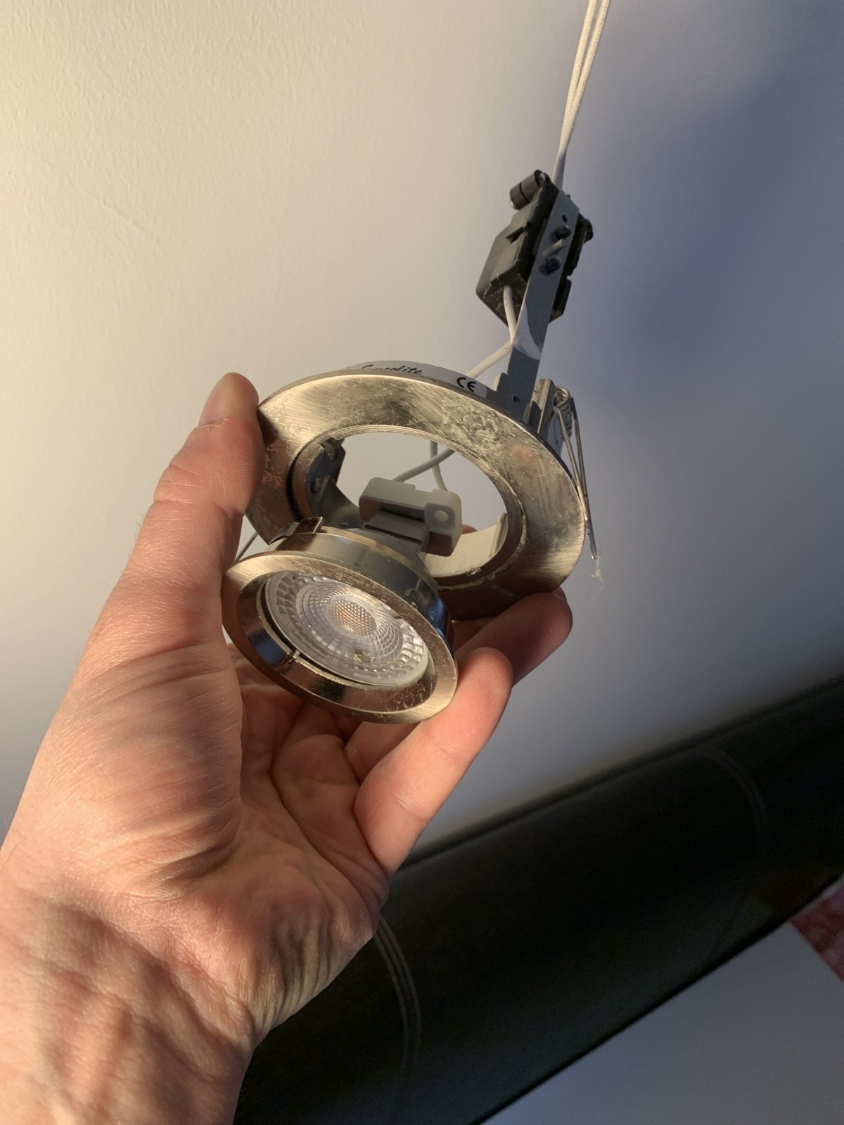

Now, a single light in the house has been unusable since I moved in. The light flickers like a strobe and the red transformer buzzes. As such I don’t use the lights in that room.
There’s obviously something a miss, so I’ve checked for loose connections and damage and I’ve found some. The wires going to the bulb holder are exposed through the insulation and the choc block in the connection box is discoloured. I don’t know if this is the cause (can’t see where it would short) or a symptom (overheating). Either way, I’d like to replace this light unit in its entirety (transformer, choc block and bulb holder) and re-use the existing metal surround.

If you must buy things from CEF and also must have that useless design of 12V lamp, then this: https://www.cef.co.uk/catalogue/products/149477-low-voltage-lampholder-c-w-180mm-silicon-cable is the lampholder.
However the problem with that one is that the transformer is 20-60W and the LED lamp in there is probably only 5W, so the two are not compatible.
A far better option is to buy GU10 lampholders, GU10 LED lamps and dispose of the transformer completely.
https://www.cef.co.uk/catalogue/products/1550860-gu10-convertor-kit
GU10 lamps are the same physical size so will fit into the existing metal frame, and there is far more choice in GU10 LED lamps than in the 12V versions.
Other much cheaper suppliers are available.
Well It looks like your using what was probably a low voltage installation and someone has now fitted an LED lamp. LED need led drivers not electronic transformers, this will do exactly the same again. I would suggest you get a GU10 lampholder and take out the transformer and wire 240v straight in and then buy the Aurora Enlite GU10 lamps (these are good lamps and perform well) They also have all necessary drivers built into the lamp and lamps more widely available.

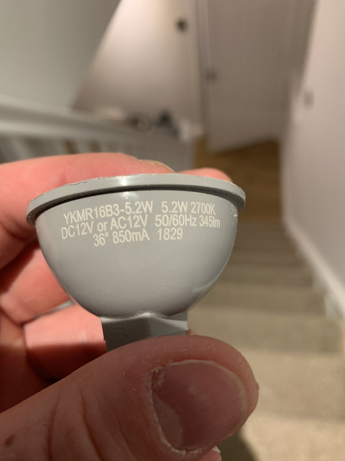

The bulbs that had been fitted in these holders were indeed LEDs:
Could these have been the cause of the overheating?

I would also expect higher conversion losses with an LED retrofit so the lamp itself will probably run hotter.
Pedantic!
Whether the conversion is done inside the lamp capsule or an outside SMPS I imagine the losses and heat generated are similar.
I converted mine and run the Enlite ones and have no issues. You can run the led of a decent transformer (but they are not made to and they can get warm, flash, and certainly shorten the life of the lamp. The Transformer you have is not what I would say a good one.)
Convert all the way would be my choice
