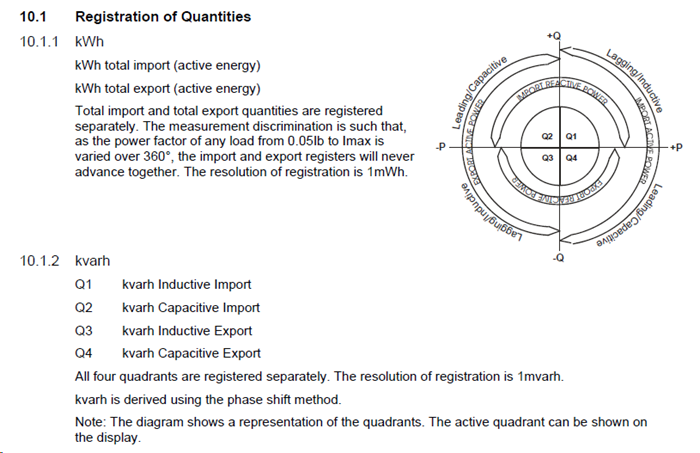

Are you sure that your 'main meter' cannot give you (and/or cannot be configured to give you) the information you want? Although not so-configured (since I don't have any solar generation) my seemingly pretty modest (not even 'smart') electronic meter appears to have countless registers, including ones that can be configured to record & display total kWh import and total kWh export.

True, but the suppliers meters obviously have to be able to do that -and, as I said, my seemingly modest one certainly has the potential ability so to do. In fact, it can do a lot more than just measure total import and export kWh - for example ...
