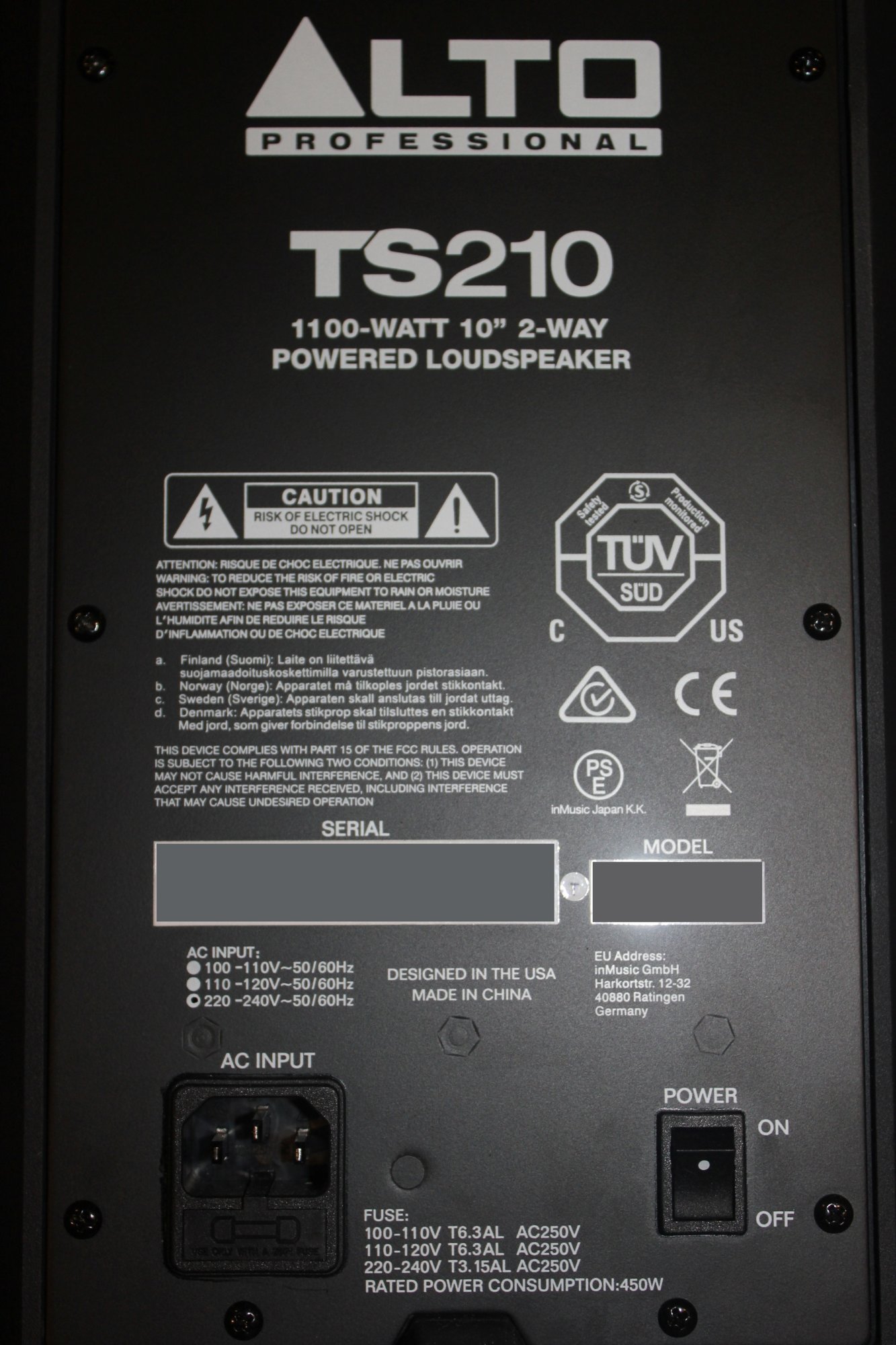

So a couple of months back I got a pair of Alto True Sonic TS210 PA speakers for outdoor events. However the wattage rating of them is strange to say the least.
According to https://www.altoproaudio.com/downloads/Alto-Professional-TS210-Spec-Sheet.pdf, they have a continuous RMS power rating of 550W and a peak power rating of 1100W.
How can that be when Peak Power = RMS Power * √². 550W RMS should be 777W Peak.
Further more, they have an mains input power rating of 450W (See bottom of photo).
Even if the 550W/1100W power rating is just that of the physical drivers and not what the built in amp puts out (Block diagram in PDF says 200W HF Power Amp, 400W LF Power Amp), that does not explain the ratio between RMS and Peek rating based on that RMS is Peak Power ÷ √².
Any ideas?
Regards: Elliott.
Yes, a lot of it is down to "Marketing specifications", and a lack of understanding about how audio systems work. There's not jsut RMS and Peak, there's Music Power, Peak Music Power, etc etc. Too much to reproduce here, so:
https://en.wikipedia.org/wiki/Audio_power
I once went into Currys and asked how an amplifier they said had an output of X watts only had a mains input power of X/3 watts. They were stumped.
The manufacturers are liars. The output is not 1100W, 550W or anything even close to any of those.
If the input power is really 450W, the sound output must be less than that. Probably a lot less.
Anything claimed by audio manufacturers should generally be ignored.

You are asking about loudspeaker input power, this has nothing to do with amplifiers but all to do with the physical limitations of the cone movement. Generally speakers cone excursion or x-max (max rms) is at half the power of x-damage (peak power), and is also only 3dB difference which is an almost imperceptible volume change to the human ear.

That all makes sense. However, I imagine that those who make claims about the output power of an amplifier (be they sensible, ridiculous, straightforward or misleading claims) are working on the basis that the amplifier is feeding speakers at least able to handle the amplifier's peak output - in other words, so that the amplifier, not the speakers, is the 'limiting factor'. Well, I reckon they should!
