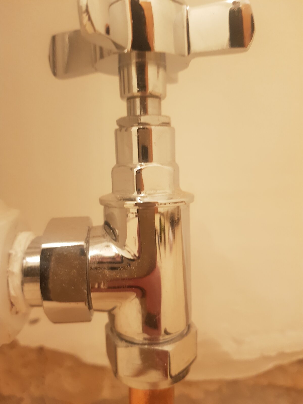

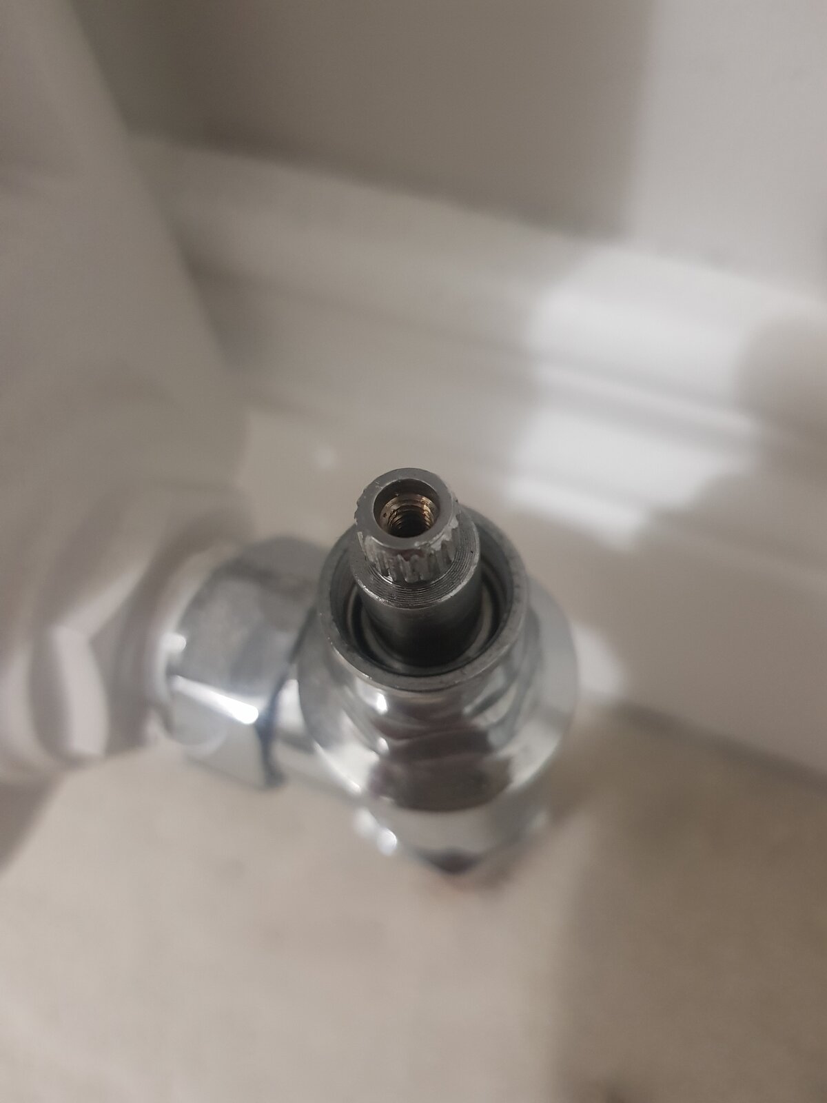

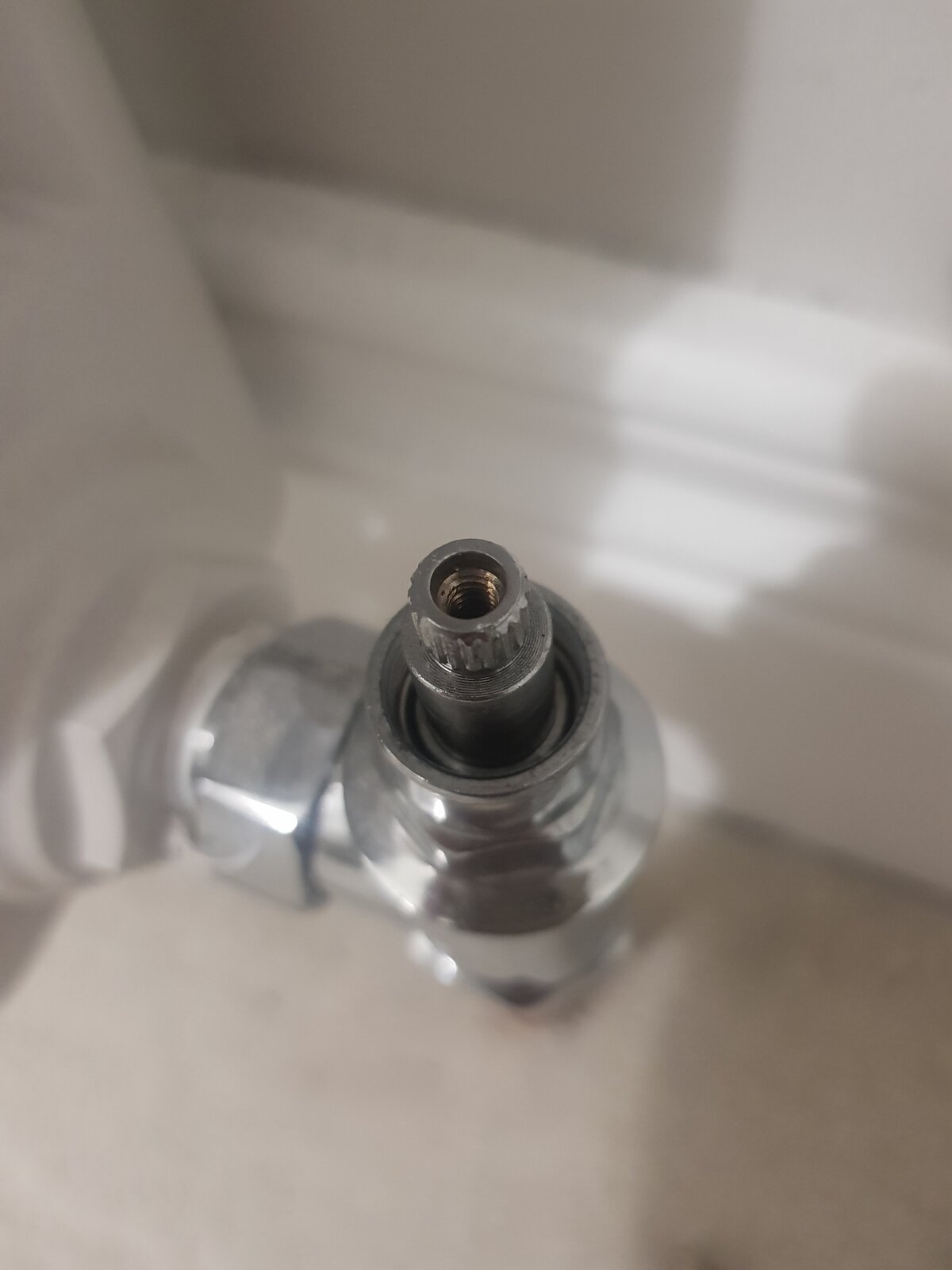

Looking some help, slightly tapped the radiator valve and a leak has appeared out of the top where the spindle is. Quick google and most suggestions are to tighten the gland nut. I've taken the spindle cap off, undone screw underneath but there's no gland nut (pic attached). What do I do here?

Needs stripping and new O ring seals fitting. Or just fit a replacement valve.
Only had the valves less than 12 months, what's involved in stripping?
You would need to firstly relieve pressure in the system ,or preferably drain down ,and take the valve to pieces . A side view of the valve would be useful , in order to give clearer advice,but the hexagonal shape is likely to be where the valve body splits from the headworks.

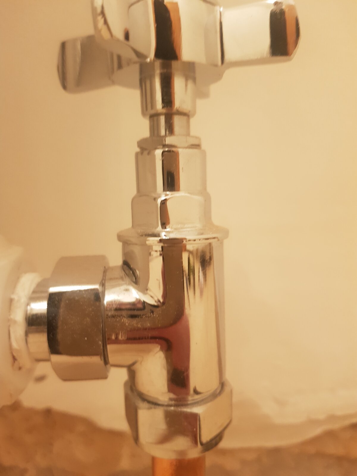

Here's the side view, initially it looked all one piece but looks maybe like the top chrome piece could come off with a spanner, would there be a gland nut under there?

The small hexagonal nut ,which appears to have been removed in your first pic, can be used together with PTFE tape wrapped tightly around the spindle ,to stop the leak
Thanks, assuming thats a good temporary fix, but also assuming water shouldn't really be in that part of the valve? Am I also right about the nut a bit further down, should this valve have a gland nut?
The small hexagonal nut on a " conventional" tap ( which your radiator valve appears to be designed to look like) would be the gland nut. But it doesn't appear to have a gland on yours ,so the nut is just decorative. However wrapping PTFE as suggested would prevent water getting up past the spindle. You are correct water shouldn't get there.
I believe the larger hexagonal shape would unscrew from the base ,and allow the spindle to be removed from below , together with it's O rings.
