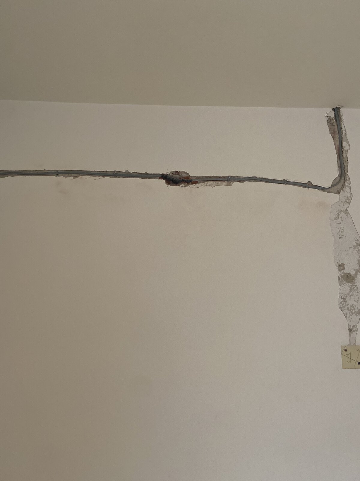

Hi,
I’ve had some work completed by a builder recently including moving a light switch. The wiring has been spliced and then covered with electrical tape, to then be plastered over.
I have a couple of questions:
1. Does the wiring look ok?
2. How should the wiring be plastered over?
No it doesn't look okay, not even sure it's completely in safe zones given it doglegs. Could well be electrically sound but it's a bodge.

No that is very wrong.
Wrong method
Wrong place
Your builder and others like him (yes kitchen fitters I'm looking at you) are why Part P was invented.
Joint wrong
Joint method wrong.
Cable not in protected zones.
Epic fail
Has he done any other electrical work?- if yes it all needs inspecting by a competent person (IE not your builder).
EDIT You'll also need RCD protection on that lighting circuit now that cable has been moved. But before you worry about that the cable needs replacing (so there isn't a joint in it) and rerunning so it is in a safe zone.

I have an electrician who has done some work for me on other occasions who I can ask to rectify the work but just so I know that it’s right next time, should the joint be in a junction box and then the cables moved to safe zones with capping covering it before it is plastered over?
Ideally it shouldn't have a join that isn't accessible, if it's inaccessible then it has to be with maintenance free connections. Capping only really protects the cable from a plasterers trowel so if it's chased in deep enough it's not required.
