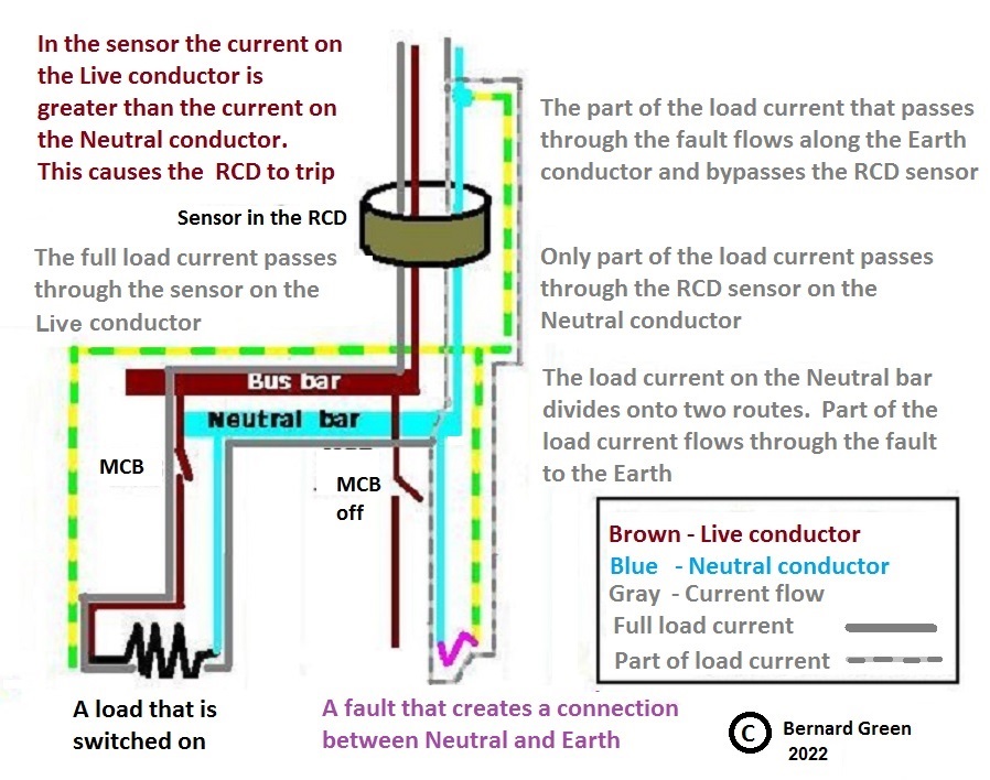

The RCD is tripping due to current flowing to Earth from either the Live and/or Neutral.
Turning OFF the MCB on the faulty circuit will not stop the fault tripping the RCD.
Many people including some "qualified" electricians believe that if an RCD trips when an MCB is switched OFF then the fault cannot be on the circuits fed by that MCB.
