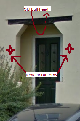

Hi,
Hoping this is a very simple question to answer.
I currently have a single bulkhead light on the outside of my house, which is control by a switch inside the house.
I would like to replace it with two PIR lanterns, but keep the switch in place should we need it turned off.
Is this as simple as running the cable going to the existing light into a junction box to allow me to run the two new cables off of the existing circuit? If so, could let me know what type I would need, that'd be great as it needs to be outside (although it will be sheltered by the porch against the elements).
Thanks in advance

Thanks for the help, the suggested junction box is similar to what I was thinking. I need the lights on the left and right of the porch entry, so this is the simplest installation. As you can see from this image, the bulkhead is pretty well secluded from the elements behind and above the wooden beam.
One final thing, in terms of cable, there are various different widths of 3 core but I'm not sure which thickness I need - what's the driving factor for a thicker cable?
Given your layout, you need to think about where the PIR will go.
If it is located with one of the lights, then the PIR will only detect someone approaching the front door. The PIR will not see you as you leave the house.
If that is OK, then I suggest you get a separate PIR and locate it above the porch (about where the "Old Bulkhead" label is on your picture).
Then you can choose two matching lights for the sides of the porch.
For the junction, a box like Eric has suggested will be fine, that location is not going to get wet…

Eric, the box is going to be tucked in the ceiling of the porch and protected by that overhang. It ain't going to get wet, unless someone gets up to the front door with a fire-hose;)
