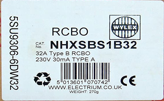

The other problem is what is made, I used Fuse Box, and in hind sight maybe a mistake as I have had type A RCBO's on back order for quite some time. I had thought I was fitting type B however it turned out type AC curve B.
As to if any manufacturer produces a type F with single modular width I don't know, even if they do, picking one up a local whole sale output may be a problem, but this
is typical type B TYPE A at least Wylex put both down even if the don't say what the type refers to, but try finding a type B curve B RCBO internet hunt will pick up a load of curve B but failed even to find type F RCBO single module width, type F RCD two module wide yes.
Wylex and Crabtree have had Type A RCDs in their RCBOs for decades
The old generation MK's were also Type A.
So if you will buy a cheap brand!
Fuse box do type AC and type A and Wylex do type AC and type A the only difference is the packet the fuse box one said type B only.
I blaim the guy who decided it was OK to have type B for both RCD and MCB there were 18 other letters he could of used even without using two letters, it was not that hard.
Had the fuse box packet said type B type AC I would have realised.
