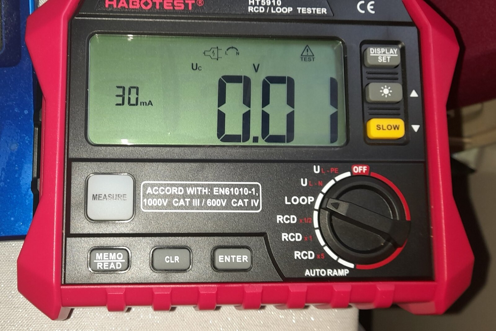

The problem is the meter used to test this is a bit expensive. ELI-on meter.jpg This one I think cost around £85, there are cheap testers,
but they will only test a radial, their pass mark is too high for a ring final, and the one shown cost £44.34 so is it worth getting a tester that expensive that will not work with a ring final?
And to be frank, as long as the circuit is RCD protected, it is not that important anyway.
